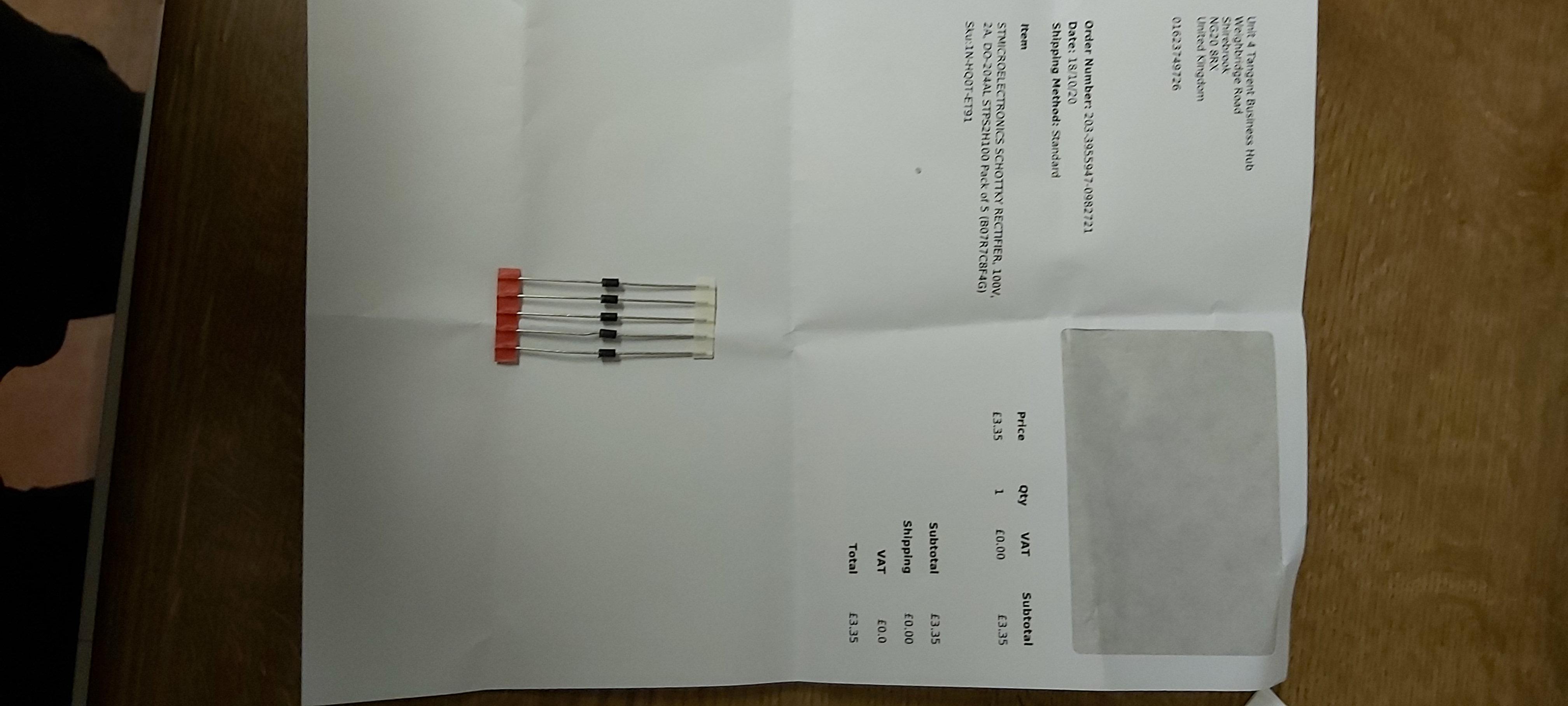

HOLLBRY Posted September 20, 2020 Posted September 20, 2020 In case anyone needs to order replacement diode: Supplier Farnell, Item Code 2849663 Description: STPS2H100 SCHOTTKY RECTIFIER, 100V, 2A, DO-204AL All123 and Whitegoodshelp 2

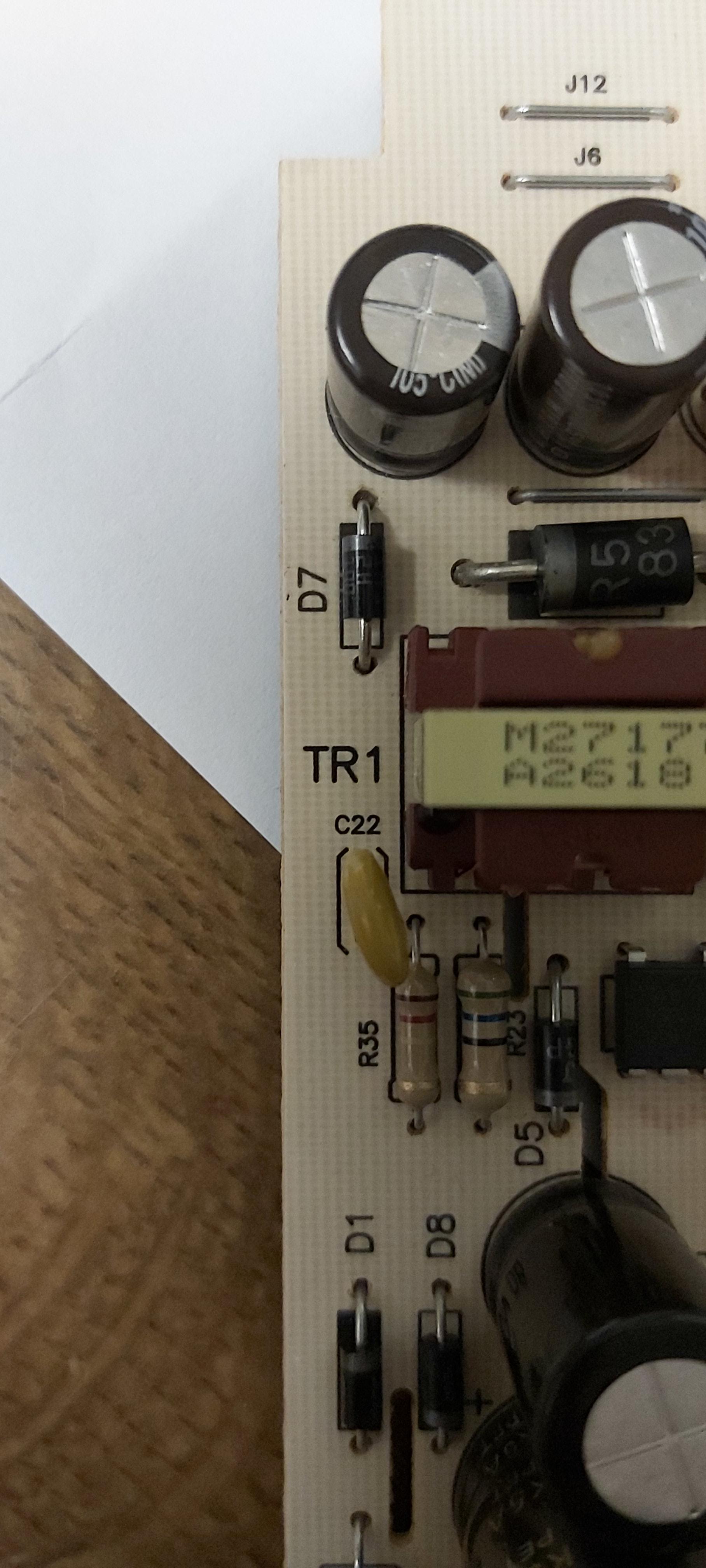

Jo f Posted September 29, 2020 Posted September 29, 2020 Hi everyone, just to comment that with all your help I've got my Beko WDR75431215 back up and running! Our machine is only about 2 years old so was pretty dismayed when it wouldn't turn on. I haven't done any electrics before other than gcse physics 15 years ago - at the time I couldn't have been less interested in circuit boards. Was pretty daunting resoldering the diode so I'm absolutely buzzing to report it worked! Cheers Bob and others Whitegoodshelp 1

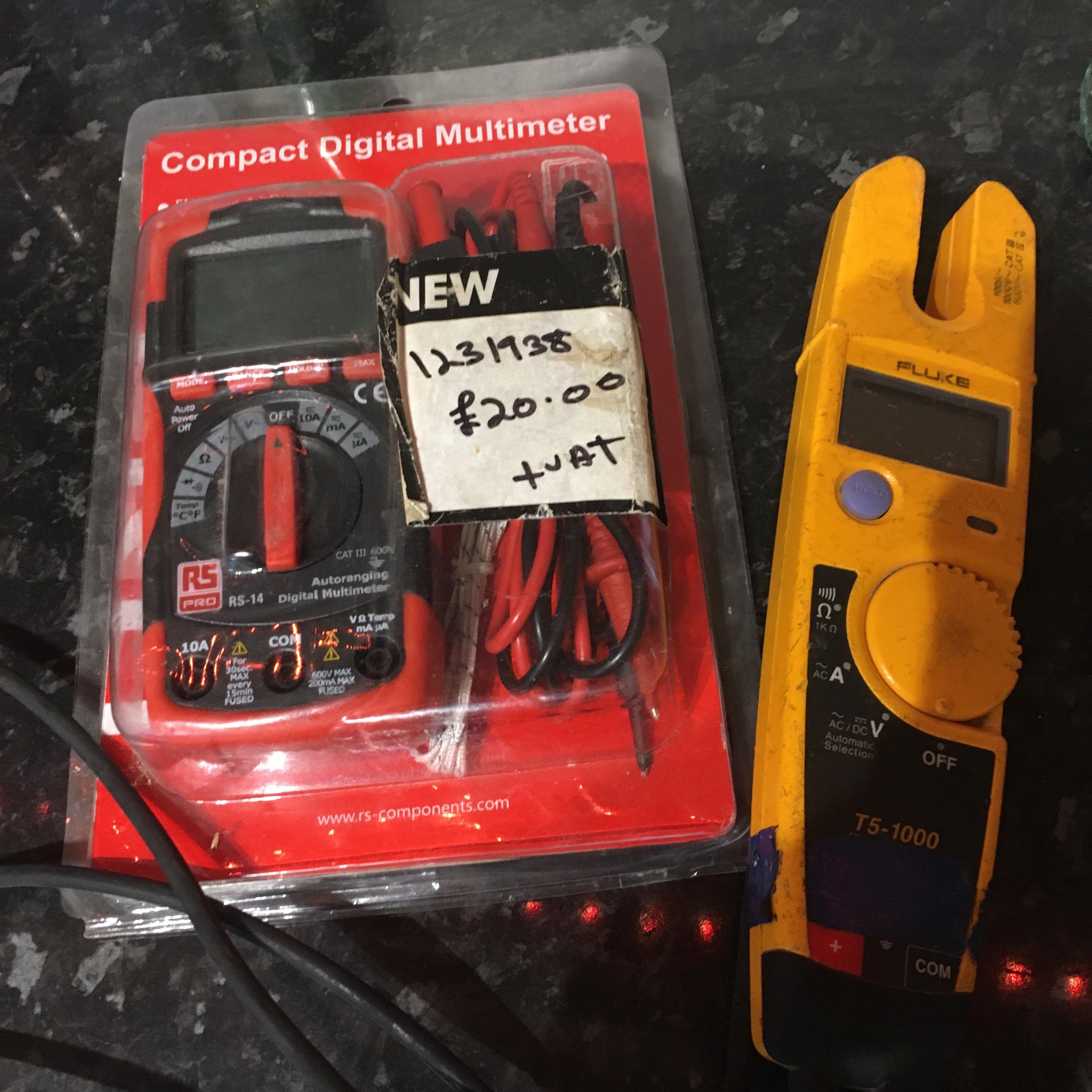

emphyrian Posted September 30, 2020 Posted September 30, 2020 I've borrowed these devices but am unsure of how to actually test the diode. Could anyone advise? Thanks in advance.
bob12241 Posted September 30, 2020 Posted September 30, 2020 Hi you don't need the fluke tester as it not suited (if memory serves)n but the multimeter should do the trick. If it has a diode symbol on it (looks like a triangle with a bar across the top and tails both ends), there are loads of videos on the web that cover it in great detail and it is a simple process. You cannot test it 100% whilst in circuit, you need to desolder 1 leg and lift it clear to test as other components have an affect on your readings. Just Google "Diode Testing" Regards Rob emphyrian 1
bradaw42 Posted October 2, 2020 Posted October 2, 2020 (edited) Hi All, I would really like to extend thanks to bob12241 - and other contributors on this thread. We have a BEKO WDX8543130W purchased August 2018 which stopped working over a week ago mid-September, with the lights off on the main pannel failure and hearing the very slight (mouse type) beep coming from the machine. After googling and finding this thread/forum for which I am eternally greatful, we set out to fix it. Therefore, for a 45p Schottky Rectifier (100V 2A DO-204AL) and a £12 Solder kit from Amazon, we fixed the machine within 45 minutes based upon comments and very very appreciated uploaded photos to this thread, and the problem was indeed to the D7 rectifier/diode on the Main Control Unit. When I initially called BEKO, they wanted to send out an Engineer as out of warranty for around £160. A local domestic appliance engineer I call said he would not come round because it is a known issue with machine and I would not get a PCB for 2 months (so to order one myself at cost of about £70 then call him). I really think that BEKO should be ashammed of themselves for using subservent parts on construction that will make the machine fail after just two years a of use. I would email them directly if I thought it would have have any use. So - Bob I'd like to buy you a drink or send money to a charity of your choice if you would like to PM me your preference. Thanks a lot to everyone - saved a hell of a lot of money. Edited October 2, 2020 by bradaw42 Whitegoodshelp 1

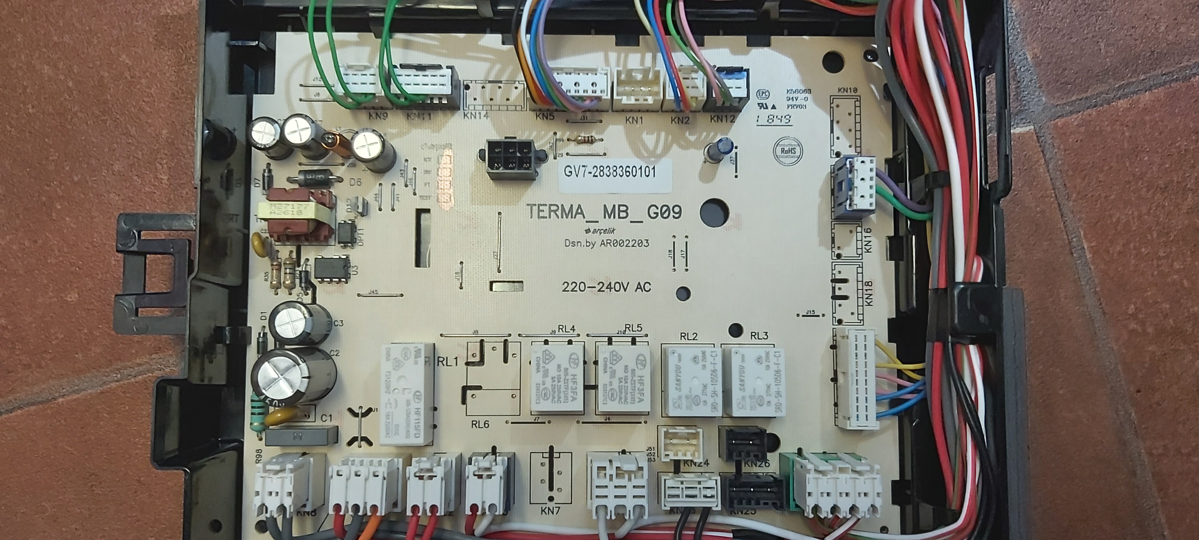

carlos Posted October 9, 2020 Posted October 9, 2020 Again many thanks to bob12241! I had this same issue with my Beko 3 years old WDR7543121B with the mother board number G09, the machine didn't turned / power on and after testing D7 that was where the problem was! Saved me quite a few £££'s Whitegoodshelp 1

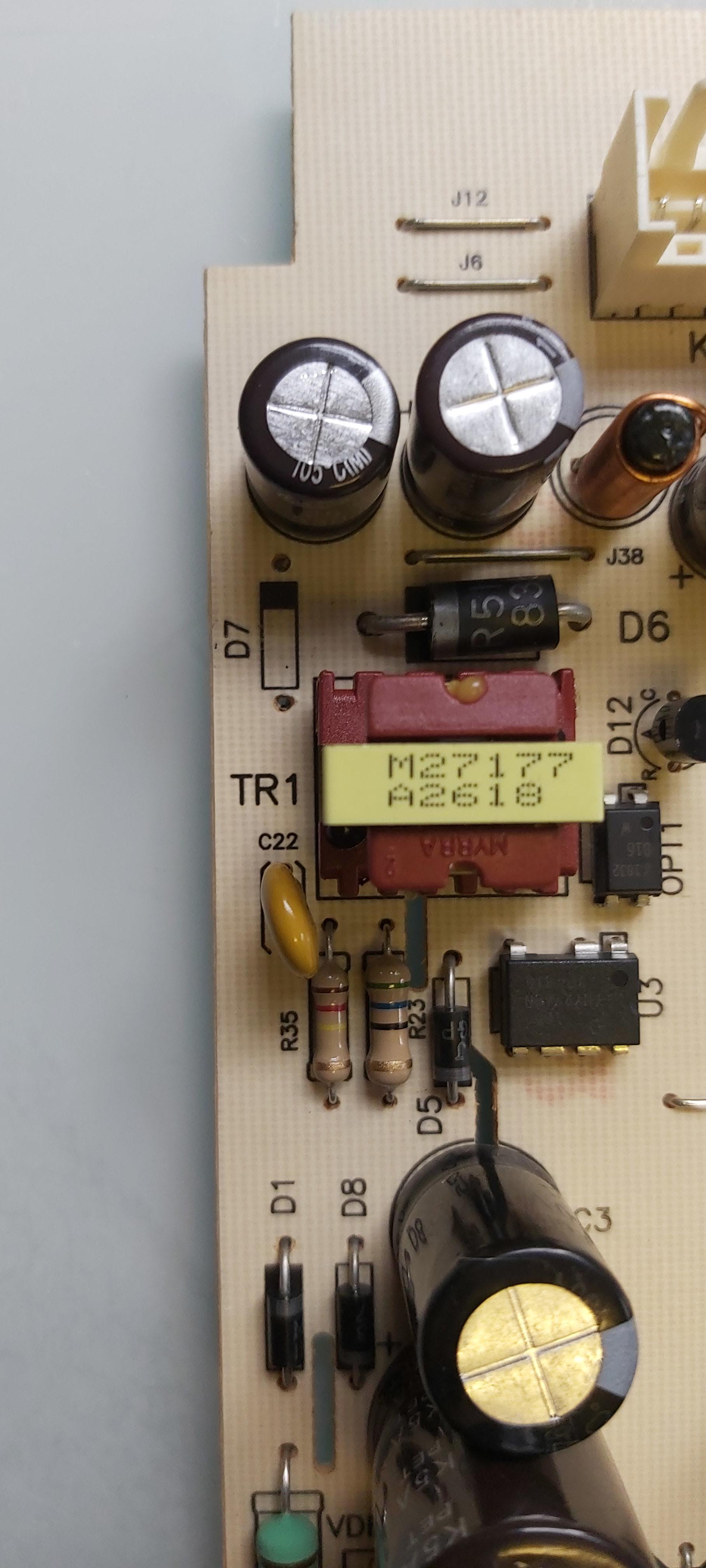

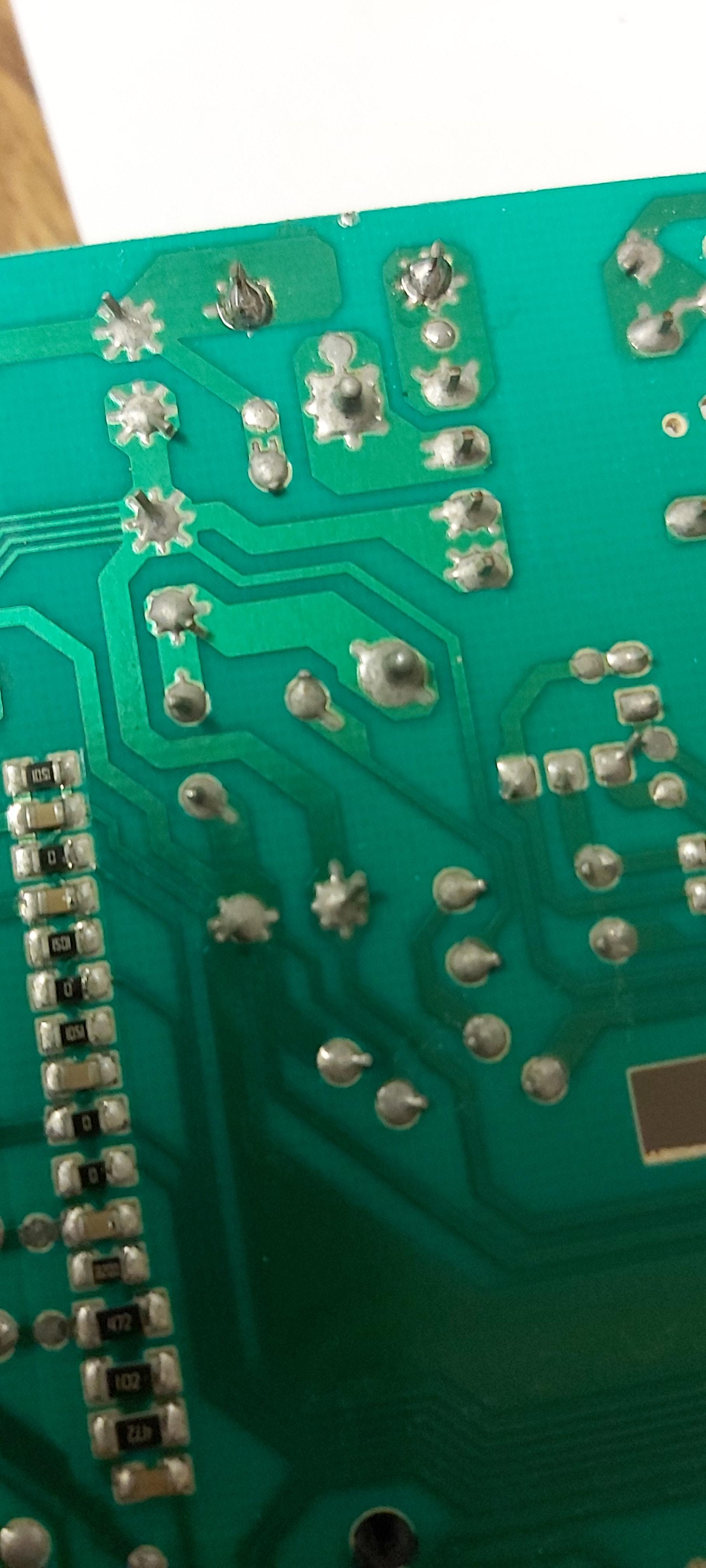

Middy Posted October 22, 2020 Posted October 22, 2020 (edited) Thank you everyone who posted about this. I have followed the thread, took the advice and bought the diodes on Amazon for £3.35 delivered. Fitted it and hey presto, we can wash our clothes again. I've added some pictures too. Edited October 22, 2020 by Middy Too many pictures the same, sorry.

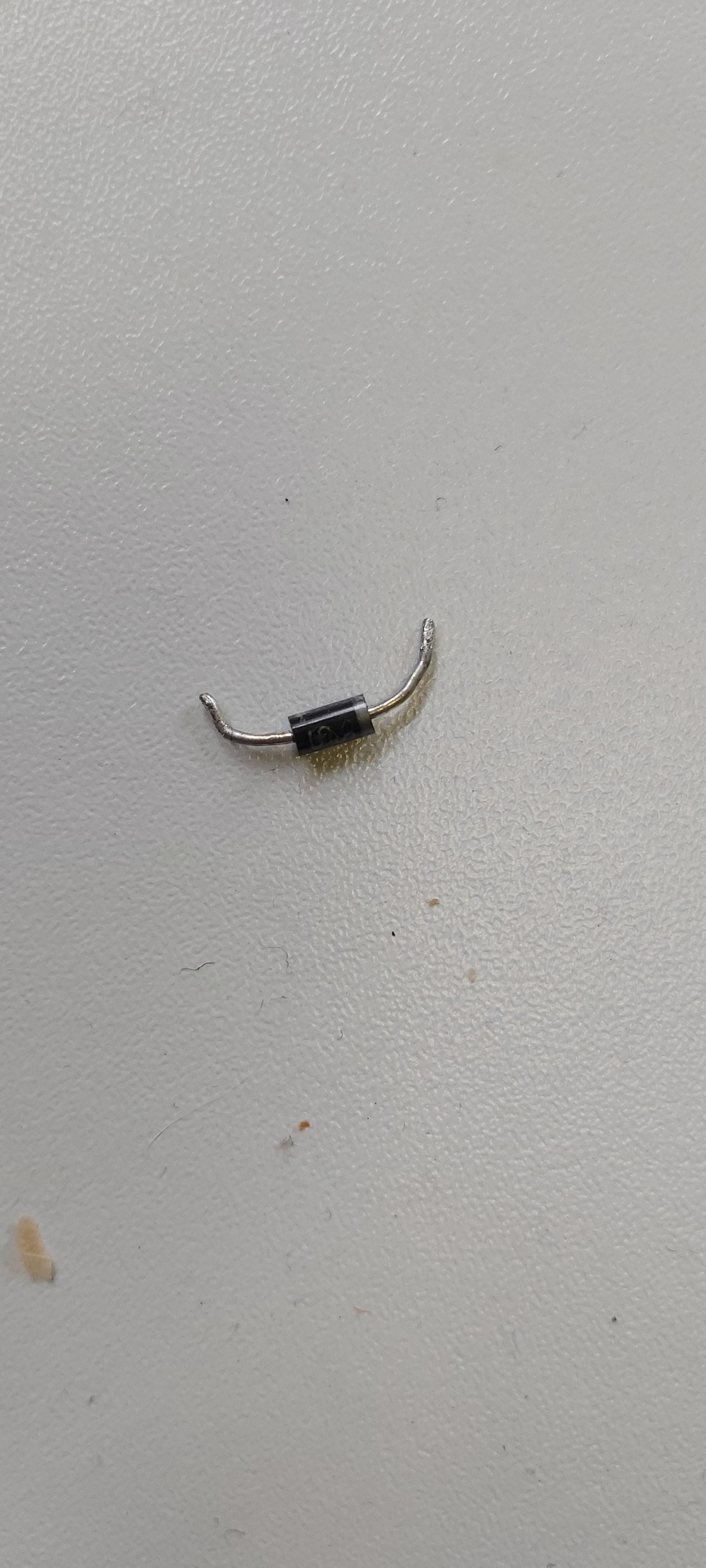

greid Posted October 28, 2020 Posted October 28, 2020 Another registration just to thank bob12241. Our Beko WDIY854310F failed to power on as of Sunday evening - mysteriously a mere 5 days after the 2 year warranty expired. Sounds like a lot of people have experienced this incredible coincidence! As in Bob’s post, D7 on the distribution PCB had failed short when tested out of circuit. Very easy 50p repair. Very happy to help anybody locally with a similar problem - we are between Portsmouth & Southampton. Many thanks, Bob. Whitegoodshelp 1
