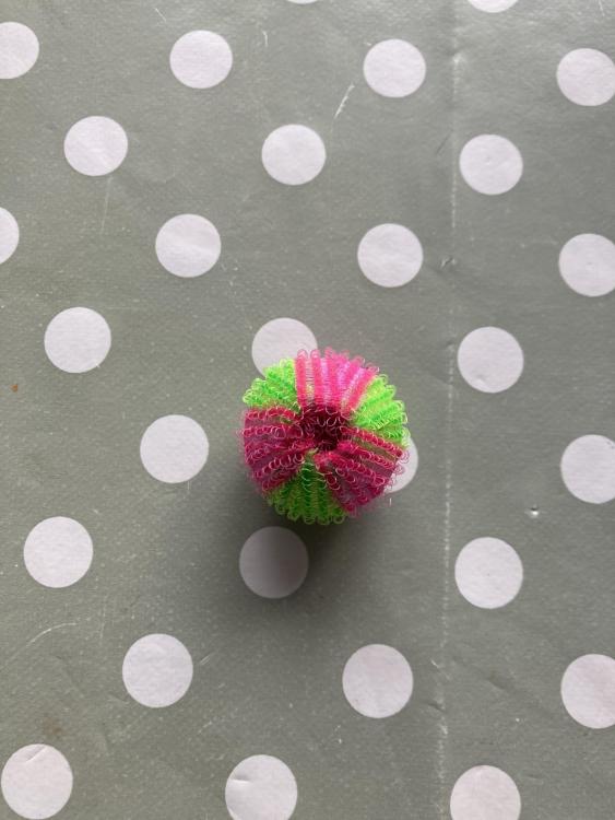

On 26/01/2022 at 12:32, Whitegoodshelp (Andy) said:
Hi Emma. What balls were they? I was thinking of the sticky roller type.

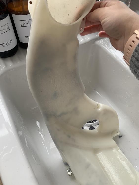

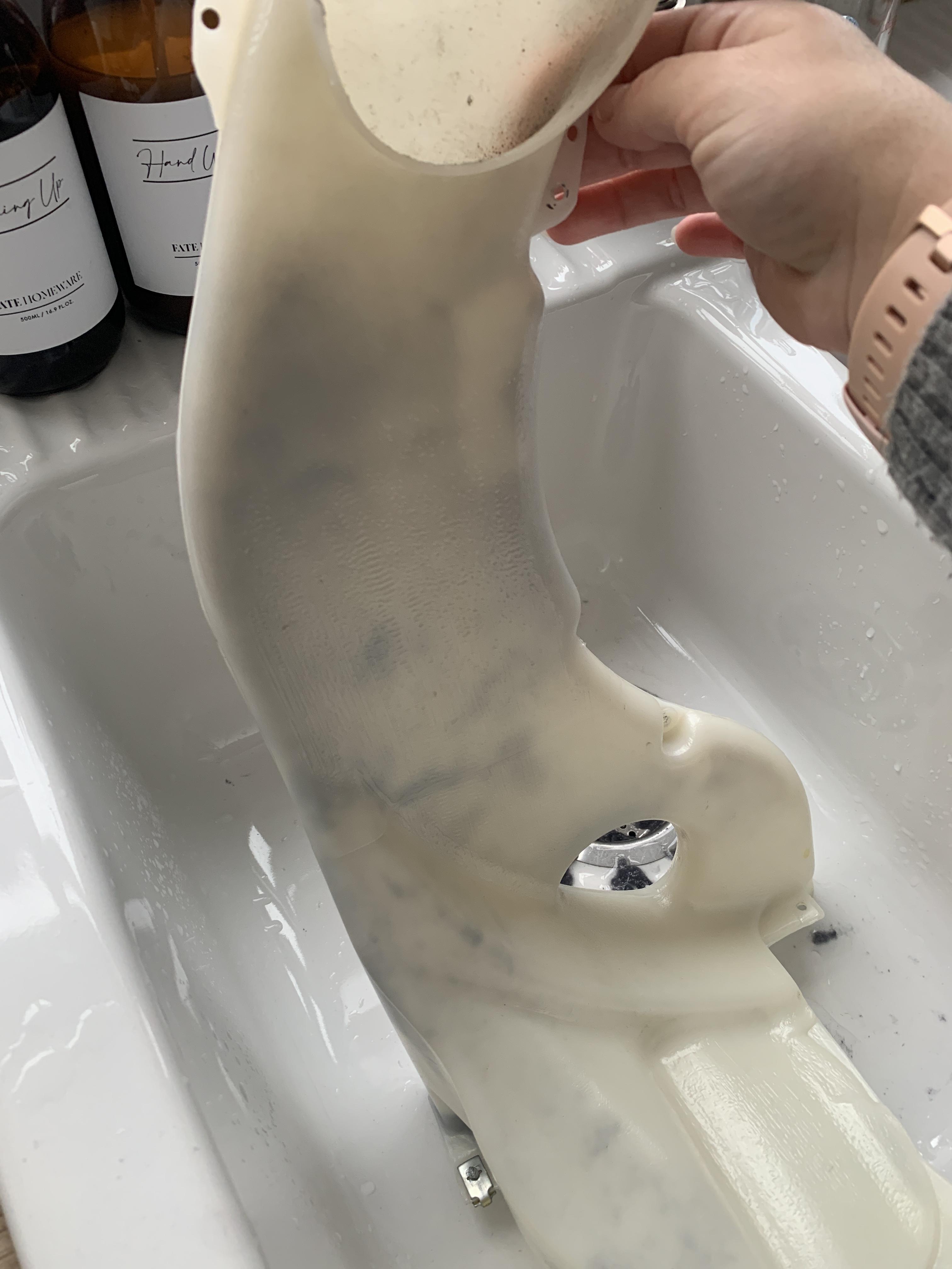

20 hours ago, Louise1305 said:
Taken the plunge today and opened up the machine to deep clean it and this is the white thing I was talking about that had a lot of lint in it previously. We only opened it up and cleaned it a few months ago and it’s full of lint again already.
Hello Louise, I need to re-ask a few questions because we have different people with the same problem but different circumstances on this thread. How often do you use the washer dryer? The lint that gets inside the condenser chamber, which is this big plastic part, is lint that is likely to have come from the drying cycle.
I use it quite rarely to be honest. I see it several times to see if it got the lint off the clothes but it didn’t seem to. I’m going to just use the machine as a washer not use the dryer now and see how that goes.
Link to comment
Share on other sites
Hello Louise. I suspect there may be a fundamental flaw in the design of washer dryers. It seems many of them suffer with a big build up of lint that clogs the dryer fan, the heating chamber and the condenser chamber. I just can't work out whether or not this happens when the dryer is being used regularly, or when a dryer is not used regularly and the lint maybe dries out and moves around. At the end of the day all lint that is removed from laundry during the drying cycle is supposed to get washed into the outer drum underneath the main drum and then get pumped away.
