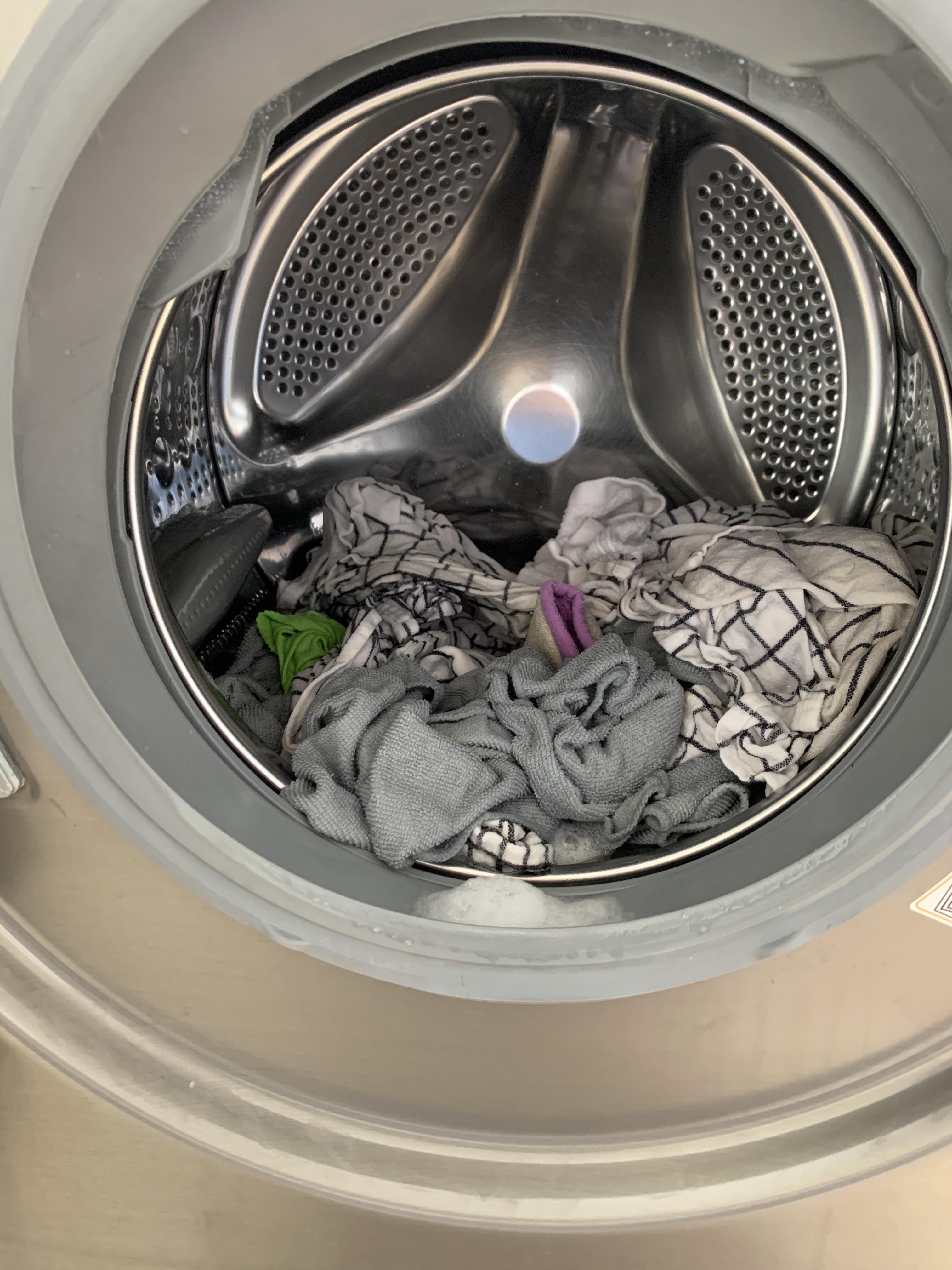

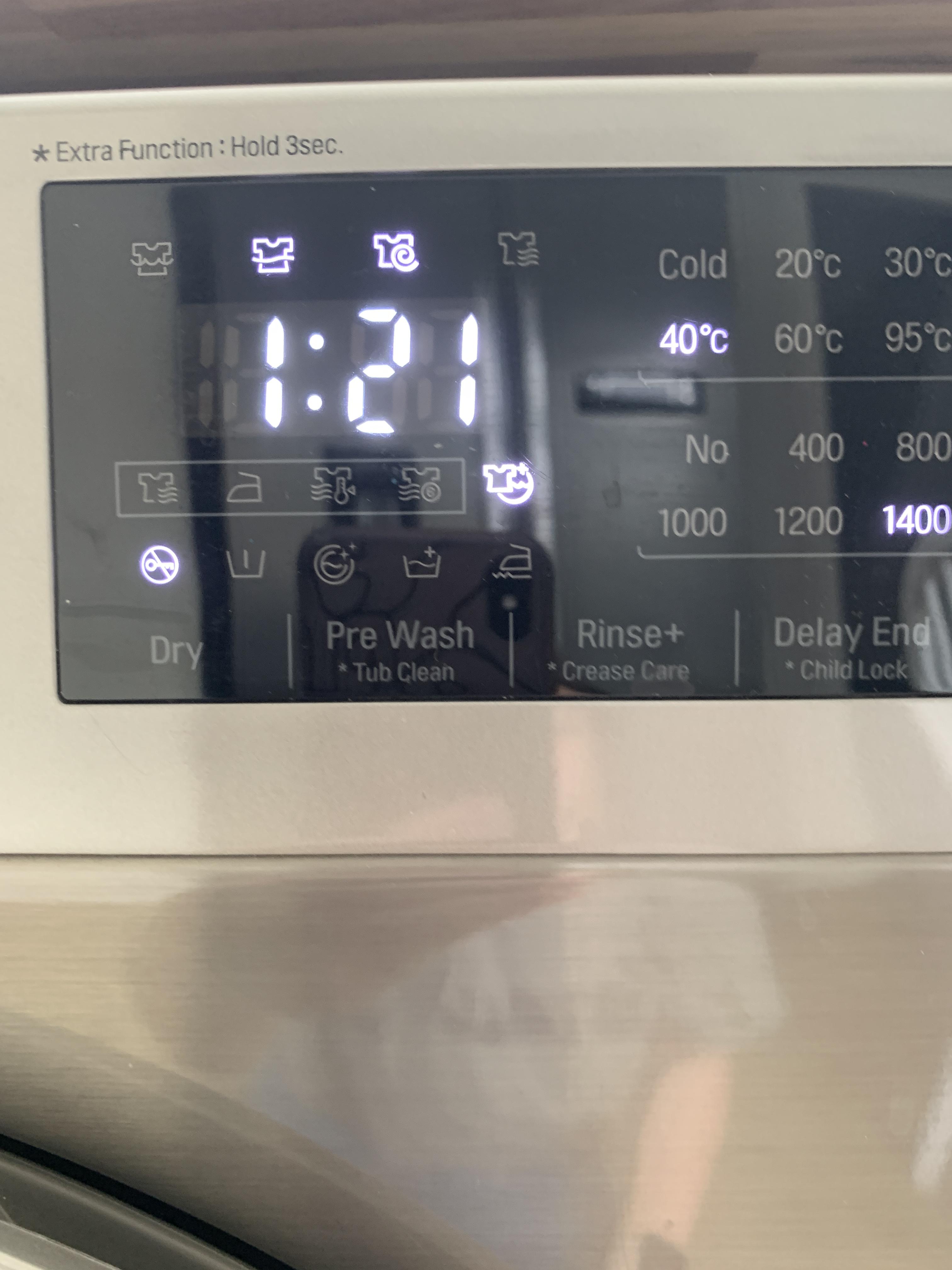

It sounds like it’s struggling and it only has one towel in
Link to comment
Share on other sites
Hi Emma. Thanks, but testing with one towel isn’t a real world test as you should never wash just one towel. The motor will not turn smoothly with just one towel.
I was asking about the wash action on the wash cycle when it’s heating up the water.
