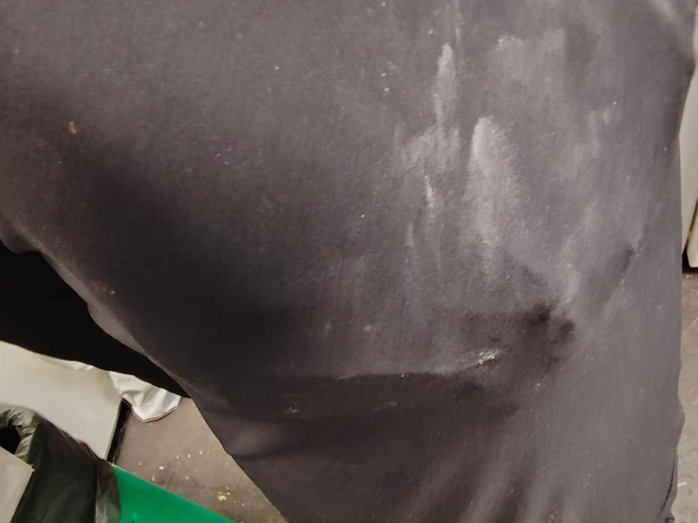

Dear friends, I was very relieved to find this forum where many of you have so clearly described and shown the exact issue that has plagued me since Jan 2022.  All fabric that I launder is, after indoor line drying, increasingly faded and stiff after each wash, with apparent whitish residue that becomes more apparent after applying pressure to the fabric with a fingernail, and with broken fraying fibres on the surface of the fabric that cause garments to lose shape and shed astonishing quantities of fibres in the house and car.  Family members suffering respiratory and dermatological conditions caused by irritation from the damaged clothing and associated dust.  10x accelerated wear and associated replacement costs.  Enormous time wasted on excessive dusting and vacuuming and on shaking clothing outdoors before and after washing to reduce the indoor nuisance.  All of which defies explanation and resists intervention so as to appear as if caused by magic, like a curse.  The type of intractable problem that after months of failed troubleshooting common sense might suggest that one give up on finding a solution and just accept that not all mysteries can be solved.  Except for the fact that functional clothing is a need and we cannot ignore the financial impost and health-damaging circumstances for ourselves or our children.  So we obsess and stress and reach breaking point … for years.  I really feel for you and the impact this serious issue has had on your life and your families.

Hello H. Thank you for your contribution. Yes it is a very strange issue in every way, and exceptionally frustrating for people who appear to suffer from it quite badly. I think one of the problems is that there seem to be relatively few people that suffer the issue to the levels that have been described by yourself and others in this thread. So this implies that there should be some common factor between you all that if identified could reveal the cause.
If it was caused by detergent, washing machine, the water, the quality of the clothes etc. then you would expect this issue to be a big one, with many thousands of people complaining about it. As I have said in previous posts, it doesn't seem to affect me, or anybody that I know. But, having said that I have posted a photo where one morning when the sun was streaming through my bedroom window and I shook a T-shirt before putting it on, I noticed masses of tiny fibres floating around in the air. They settled on my bedroom side table (which is white). But apart from that incident, we genuinely do not notice any issue. However, the white side table is the only surface in the bedroom that is likely to highlight it. Everything else is either bedding or carpet.

The damage progresses gradually and visibly (with a careful eye) in each successive wash and wear cycle.  First thing noticed is a slightly faded appearance on coloured and dark fabrics about 1-3 washes, then after subsequent washes fraying fibres, lots of particles shaking out after wear and before wash, and after wash and dry same on shaking out but less so, and then it continues downhill from there with excessive dust in the house/car and clothing thinning and appearing stretched and misshapen.
