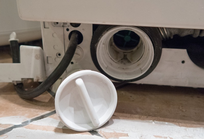

  6. I'm happy to have just found this forum as my AEG-74600 started to emit this rattling sort of sound when pumping the water out. After a while it stopped and a "C2" message showed up in the LED display. Apparently this indicates a fault with the pump: So I did an emergency draining by with the emergency emptying hose followed by unscrewing the drain pump cover. I discovered that the green "propeller" or "fan" if you like was completely loose, and my first thought is that this is the cause of my problems. I assume its job is to "push" the water through that area and out, and being loose it probably won't pump the water out properly. Anyway, I guessed it was broken off, but upon closer inspection it appears just to have loosened but I can't seem to just screw it in place (the pump just spindle just moves if I try). Is there a special way to do this?
  7. Please see attached picture. About a year ago I had it replaced and now it has become blocked, probably by normal things like coins and shirt fasteners. Problem is as you may be able to see there is no valve to turn. Am I missing something really simple or was I being a bit simple when I trusted the repair guy as he's sold me one without a proper lid,,,, or even worse put it on backwards...? Please help .. Thanks ?
