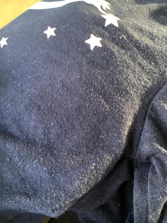

Louise1305 Posted January 13, 2022 Posted January 13, 2022 Currently this is how my washing is leaving my machine wet, absolutely covered in white fibres, and when they are dry the slightest movements creates a massive cloud of fibres. I’m forever dusting, I’m worried about my children breathing all of this in. I’ve tried everything you suggested, I’m using the longer setting, 40 degree wash, I use surf powder, I’ve tried to dry the lint out of the machine with the dryer on. And this is still how they’re coming out. I think it’s got to the carpet right? But I’m thinking surely the machine should be getting rid of this excess lint? If it is from the carpet? This is my washer model number.
Root Admin Whitegoodshelp Posted January 13, 2022 Root Admin Posted January 13, 2022 19 minutes ago, Louise1305 said: Currently this is how my washing is leaving my machine wet, absolutely covered in white fibres, and when they are dry the slightest movements creates a massive cloud of fibres. I’m forever dusting, I’m worried about my children breathing all of this in. I’ve tried everything you suggested, I’m using the longer setting, 40 degree wash, I use surf powder, I’ve tried to dry the lint out of the machine with the dryer on. And this is still how they’re coming out. I think it’s got to the carpet right? But I’m thinking surely the machine should be getting rid of this excess lint? If it is from the carpet? Hello Louise. When you say the washing is wet do you mean it's not spun properly? Also is the carpet white, the same as the white fibres? Is the carpet new? Is it man made fibre subject to static electricity? I'm wondering if somehow the fibres are electrically charged and sticking to the laundry. Need a repair or spare parts? Book a Repair | Spares4Appliances WARNING: Read this before attempting any diy repairs. No representations or warranties are made (express or implied) as to the reliability, accuracy or completeness of advice. I can't be held liable for any loss arising directly or indirectly from the use of, or any action taken in reliance on, any information on this website, which is given free of charge and in good faith.
Louise1305 Posted January 13, 2022 Posted January 13, 2022 8 minutes ago, Whitegoodshelp (Andy) said: Hello Louise. When you say the washing is wet do you mean it's not spun properly? Also is the carpet white, the same as the white fibres? Is the carpet new? Is it man made fibre subject to static electricity? I'm wondering if somehow the fibres are electrically charged and sticking to the laundry. Hi Andy, no I mean just damp out of the machine before drying. But this is the surface of the clothes as soon as they come out of the machine. And then when they dry the fibres fly everywhere. The fibres on the surface of the clothes do seem quite wirey like wool. The carpet is a mixture of greys and it is a wool loop style carpet, I’m not sure what kind of fibres it is whether is it man made, I assume so? I do find it sheds quite a lot, when I vacuum it easily fills the Hoover with grey fluff but I didn’t know what was causing what. Is it the clothes causing the carpet to be dusty or the other way around. I had the carpet fitted in the summer of 2020 and to be honest I didn’t see a problem with my laundry before then, I had been using this washer without an issue since October 2018.

Louise1305 Posted January 18, 2022 Posted January 18, 2022 This is the amount of lint I get every single day just from my stairs and landing. And I don’t know if it’s the clothes causing all of this lint but when I shake them loads of fibres come off them. And the dark washing comes out with loads of fibres stuck to the surface.
