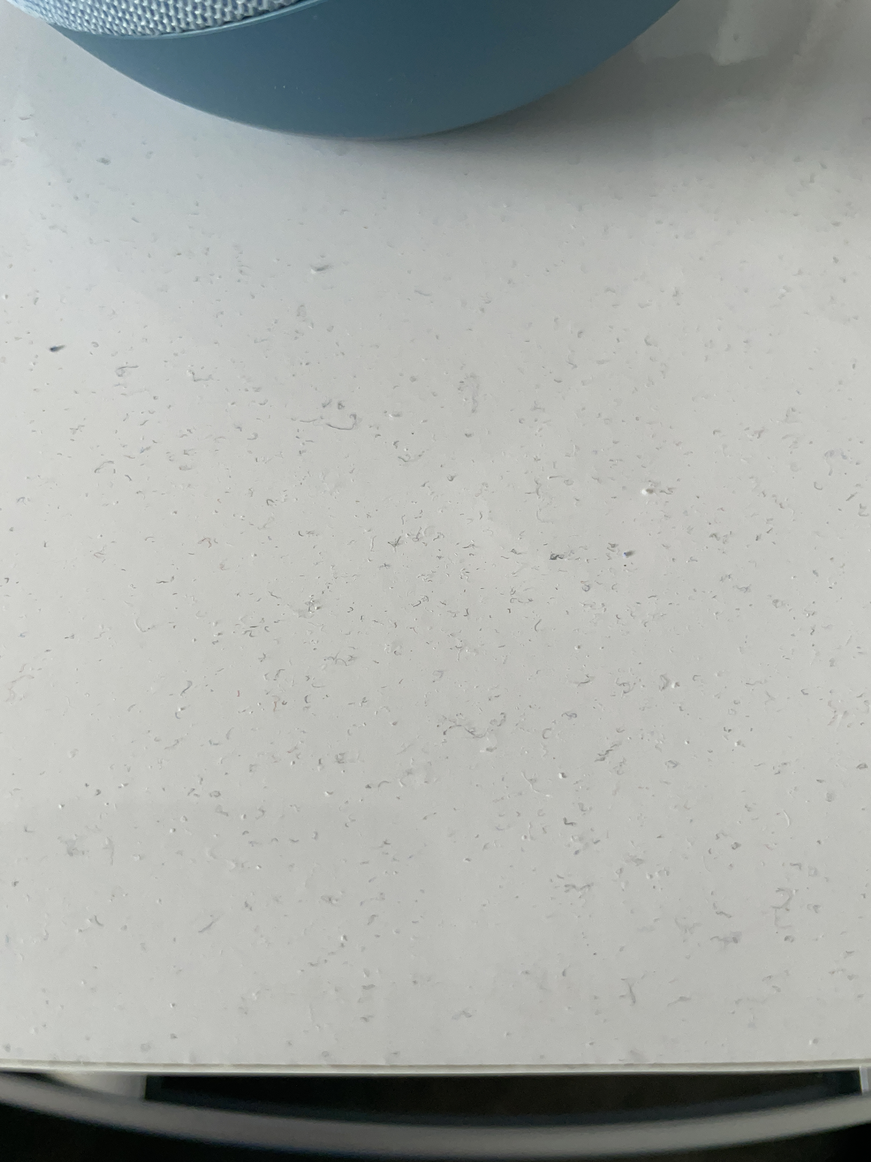

This is a photo of my bedside table now. It's covered in fibres as you describe. But I've been shaking and thrashing clothes about. I also never normally even look for dust, and couldn't see it anyway without my reading glasses on.

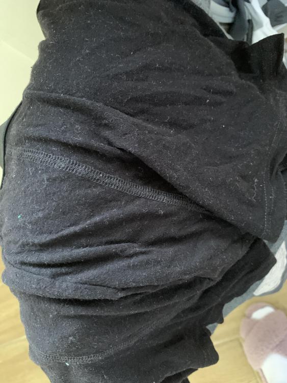

Wow. I have been having the same problem now since having a new lg washer. I’m hoping this might help, or worth a try. I found that washing the same but put spin down to 800 has helped so much. Think the new machines spin so fast it’s ruining clothes.
So I bit the bullet and bought a new washing machine and this was how the first wash came out. What am I doing wrong? I can’t cope with all of my clothes looking like this anymore.😩
what did you put in with that garment in the same wash cycle? something grey and felt like material or have you just tested washing only a black garment with only other black garments in the wash?
Just a normal dark wash. It had a grey pinafore in there do you think that would have caused this?

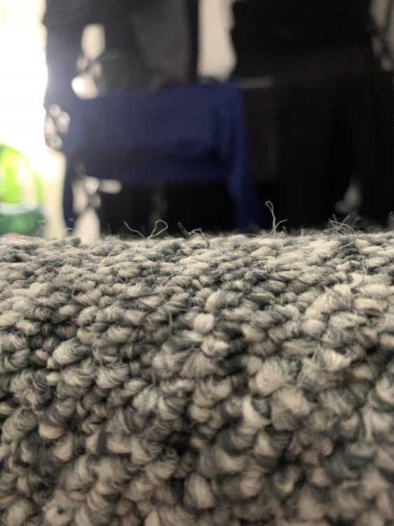

I am planning to replace my hallway carpet in the next few weeks aswell as I believe this could be one of the contributing factors in this issue of lint dust. I have attached a photo of the carpet surface and the amount of raised fibres. When I clean the bottom of our hard sole slippers there are loads of grey fibres coating the surface. If you are barefoot in my house and then get in the shower loads of lint comes off your feet.

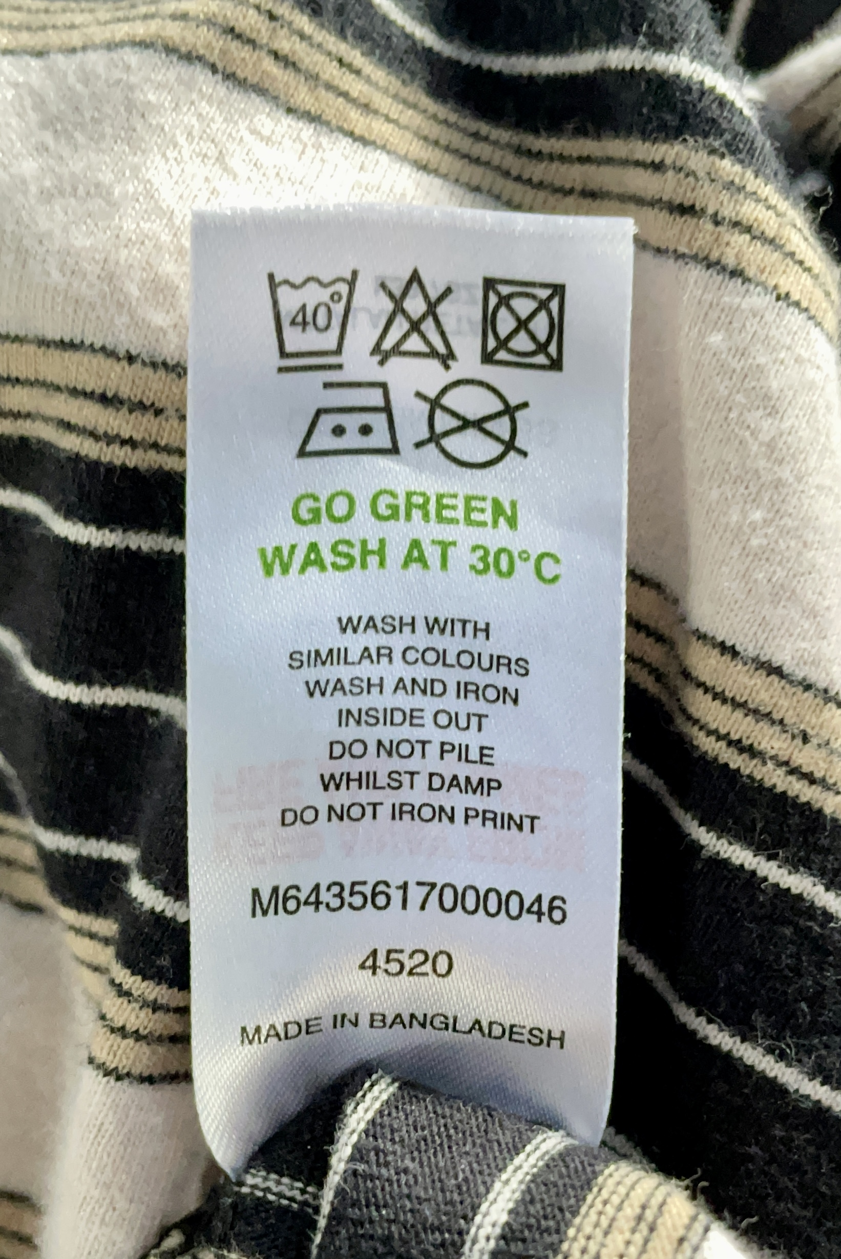

I know I keep mentioning wash labels but many modern clothes have restricted wash instructions that most people just don't look at or understand. For example, here is the wash label from just one of my ordinary t-shirts.
It says 40 degrees so many people may wash it on cottons but the single line under the symbol means it should be washed on a cycle with reduced agitation. This implies the fibres may be damaged otherwise.
It also says to wash inside out. Which again implies that it shouldn't have other items rubbing against it. It's always possible fibre damage is one of the causes of all these fibres on laundry.
It's always worth checking every items wash label and making sure you understand what all the symbols mean. This article  has some help on the wash symbols though there are more comprehensive ones out there
If you zoom in on the photo, you can see a lot of fibre damage, and bits on it. This is because it doesn’t get washed inside out as my wife doesn’t take any notice of the wash labels 😂

Here's a photo that I posted some months ago of my own bedside cabinet after I shook one of my T-shirts vigorously before putting it on. The room was filled with a cloud of microfibres, which was pretty striking because the sun was streaming through the bedroom window at the time. After a minute or so, all of these fibres settled on my bedside cabinet, and presumably all over the bedroom.
However, I personally did not consider we have a problem. I know for a fact our washing machine is working perfectly okay. I also know my wife doesn't observe the wash labels, despite me mentioning it several times. Her attitude is that it is totally impractical to observe them, and I have to concede that she has a very good point.
But after this incident I just forgot all about it, we have never noticed any other problem. For me, I just assumed that as long as I don't vigorously shake any items, the microfibres just stay stuck to the laundry and invisible – as long as you have not washed dark items with light items. In that situation, any light microfibres that get onto dark fabric will show up, and any dark microfibres that get onto light items will show up.
