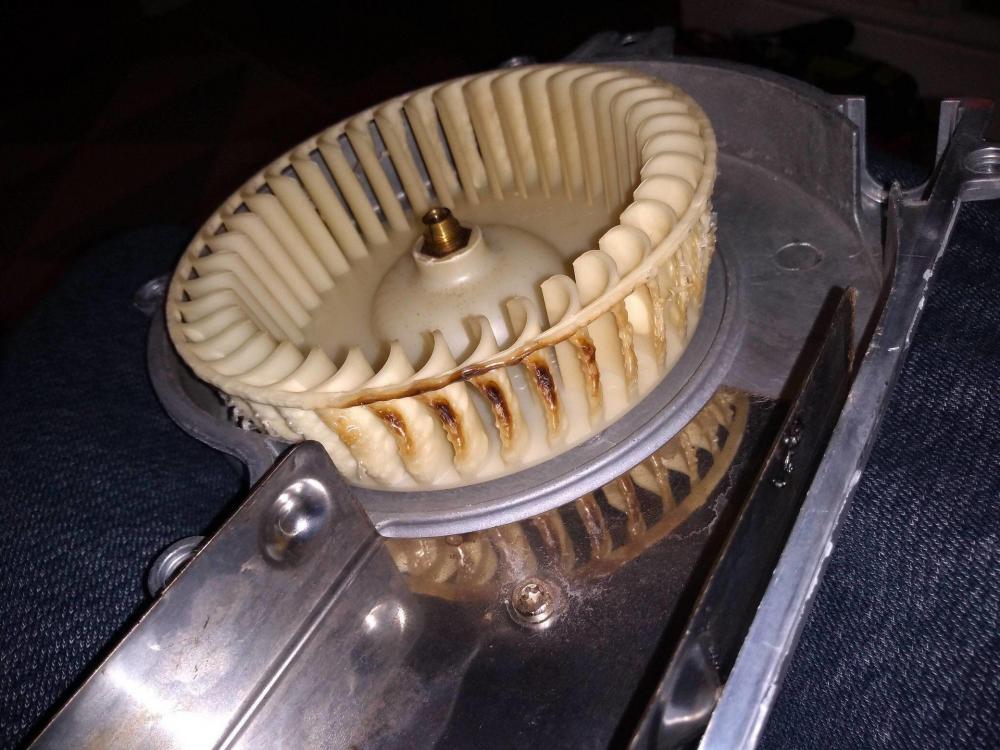

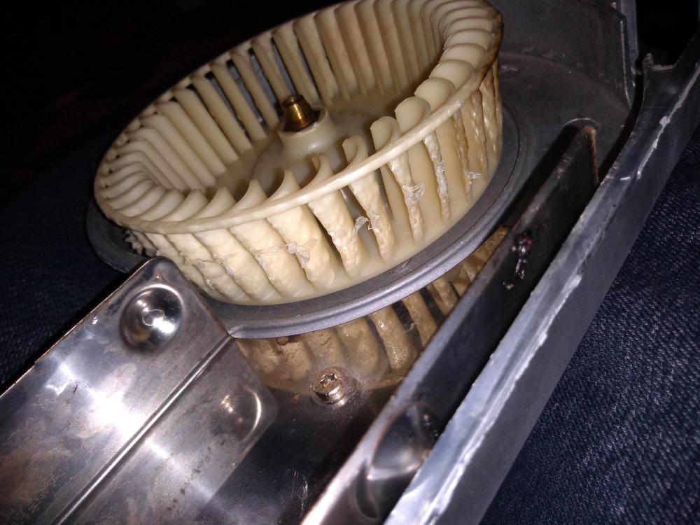

  2. Hello all. I'm struggling to repair my Indesit IWDD 6105 B ECO UK model washer dryer which displayed F13 error code last time it ran. Since first spotting the error, I have tried following all good advice available online. I've opened the top lid and undone the heating tunnel. Fan looks to be in bad shape. I suspected the NTC sensor first, but its resistance readings seem close to what others have seen (~20k ohms) and it is responding to rising temperature. When I tried rotating the fan (while still attached to its motor), it seemed to have quite a bit of friction - maybe it was tightened too close to the tunnel shell, making motor run slower than normal. Barring that, I do not have any line of reasoning for the burnt fan. Also, i can spot lint residue in the fan inlet. Any help suggesting next steps would be helpful. - Abhi
