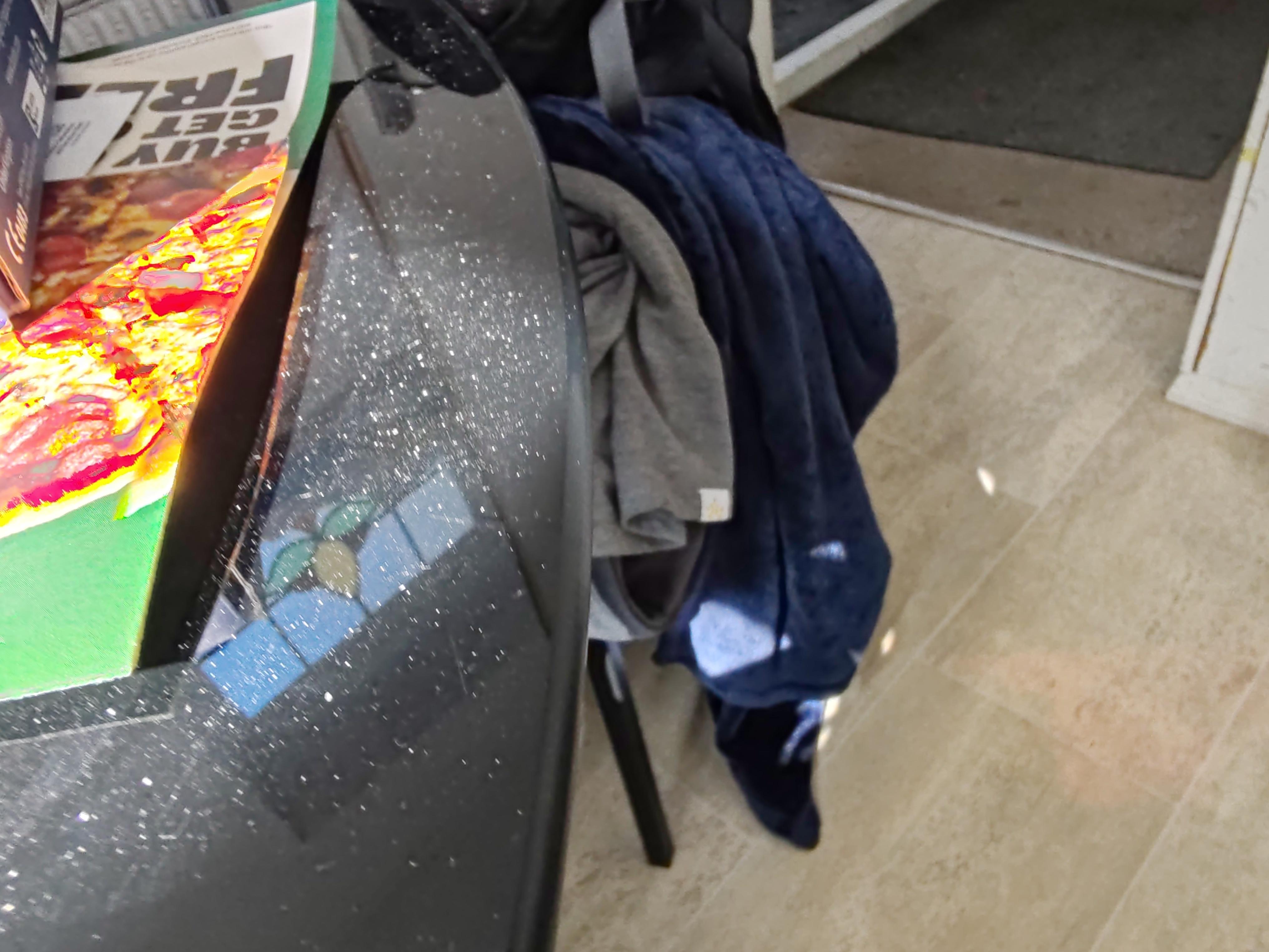

Alex2025 Posted April 5, 2025 Posted April 5, 2025 Hello everyone, just so you know I'm still here trying to figure out what's going on, this is a picture of the dust/residue that's left after I flutter my clothes around, I have no idea what are those white dots,plus I have a new washing machine, let's see if I get better results however I will update this thread very slowly since unfortunately I have a herniated disc and mobility has dropped down to around 20/30 %. I hope for the people who's suffering this malaise of dust to resolve it as fast as possible.

Root Admin Whitegoodshelp Posted April 7, 2025 Root Admin Posted April 7, 2025 Hi Alex. I appreciate your point. I don't know how long clothes have started needing this "extra care", but fault finding is all about eliminating all possible causes, one at a time, so it makes sense to check. Need a repair or spare parts? Book a Repair | Spares4Appliances WARNING: Read this before attempting any diy repairs. No representations or warranties are made (express or implied) as to the reliability, accuracy or completeness of advice. I can't be held liable for any loss arising directly or indirectly from the use of, or any action taken in reliance on, any information on this website, which is given free of charge and in good faith.
