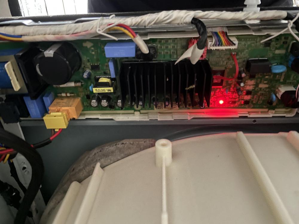

  2. Hi guys, i’ve tried using the search function but nothing coming back under fh4g6tdn2. I’ve got an LG fh4g6tdn2 front load with touch screen that wont power on the display. Now i’ve tried unplugging and holding play/pause and this resets but still doesn’t allow the front panel to light up. It does however bring the red supply light on on the back of the board which is telling me that supplyto there is in fact okay. After not getting a run command the board then switches off after about a minute. The unit itself is in the out house so my first question is “do these have a trip for external low temp”? Secondly, does anyone have any ideas on what it could be? Thanks in advance, any help really is appreciated!
