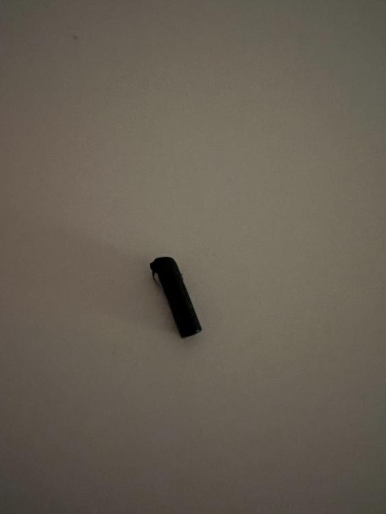

I personally hate unresolved posts! We have found the issue with the clicking. We removed the drum and noticed a tiny piece of black plastic thing was stuck to the side. Once we removed it, the sound went away. Thank you Andy for your help! The brainstorming helped us to the solution
Thank you for the update. Yes I thought it was something that was catching, once per revolution. However, what the hell it is and how it got there is another matter.
