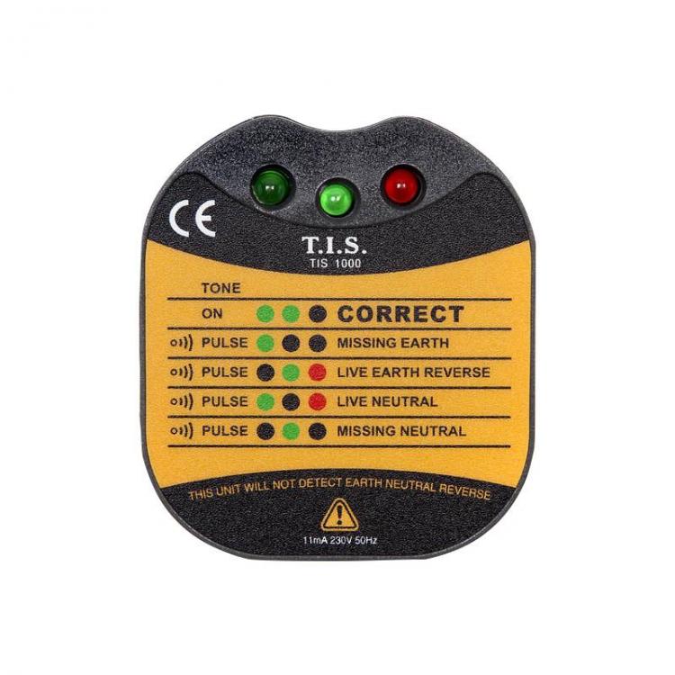

Yes tested the cabinet and thats earthed and the socket its plugged in is all wired / earthed correctly. i plugged one of these things in at the socket to test the socket :
