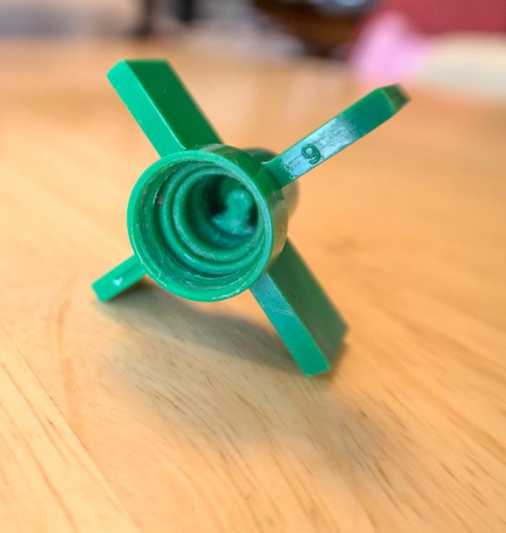

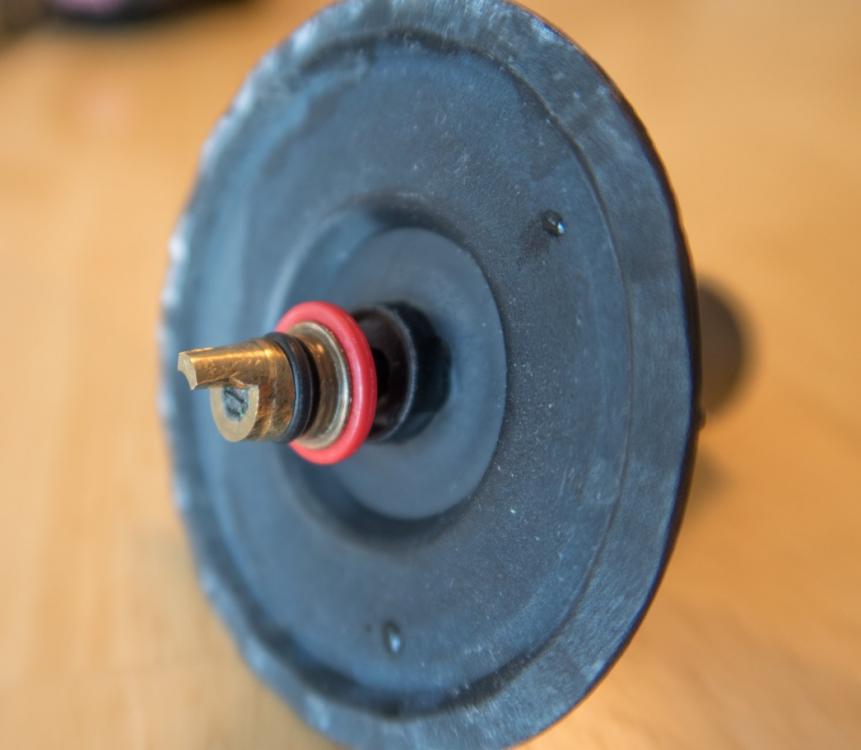

OK, so I've removed the pump (taking pictures as I go along is a good idea so I know what tube goes where etc.) and even disassembled it in order to try to refit the impeller. It doesn't seem to be damaged, but I can't quite figure out the puzzle, expecting it to fit the threads and lock on. Can someone help? (see photos below).
It looks like it's got rings and not a screw thread. My guess is that it's a push fit. It looks like it pushes on and the strange metal shaft fits inside the impeller and is what stops the impeller spinning round on the shaft?
I think you're right about not being able to fix it. I assume the impeller has been attached to the shaft before some of the other pump parts. So I gave in and ordered a new pump instead.
