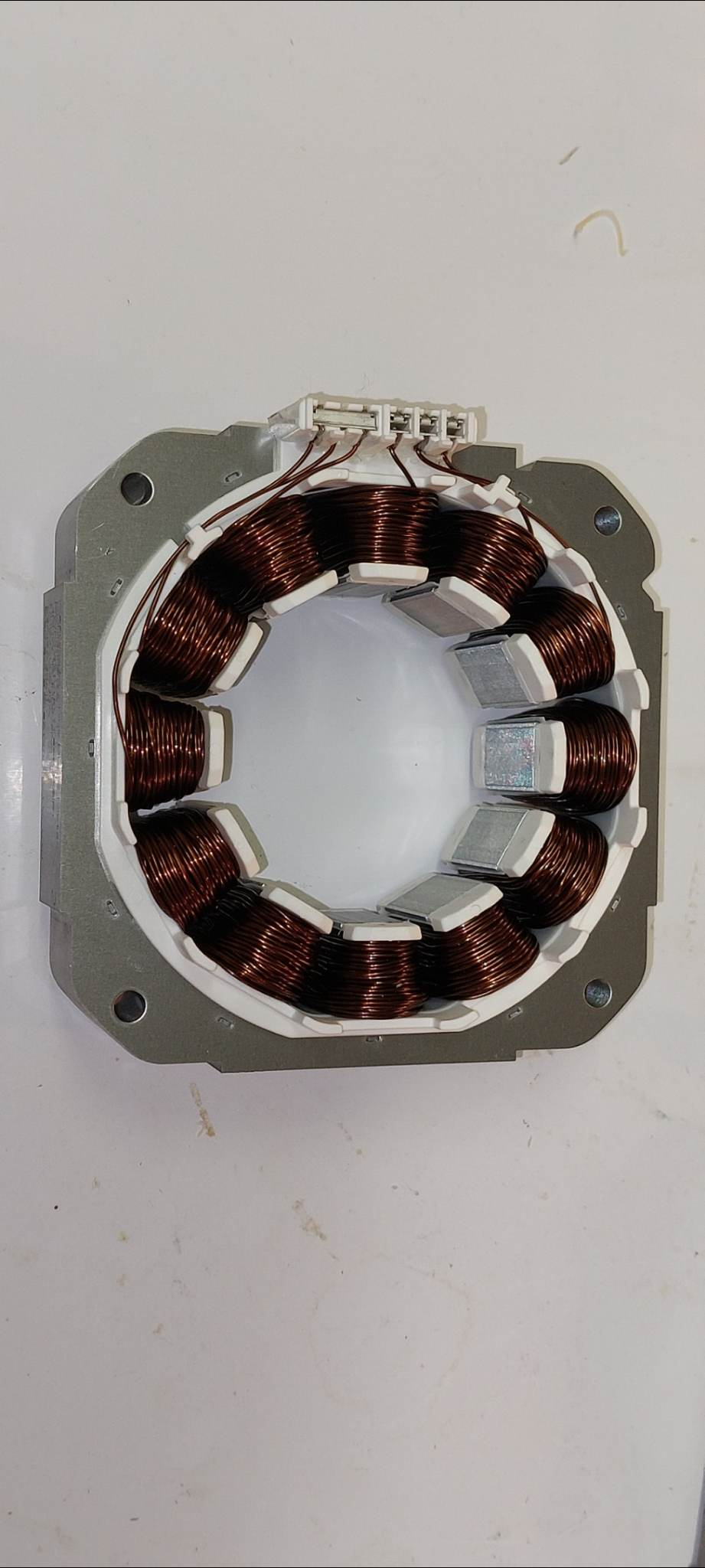

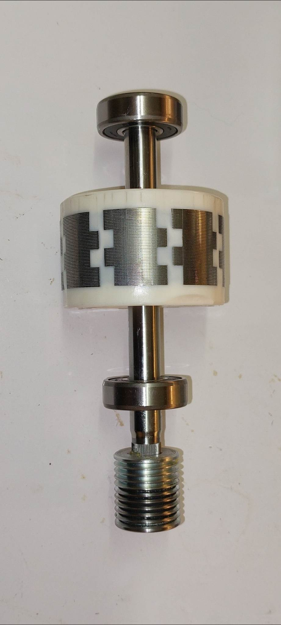

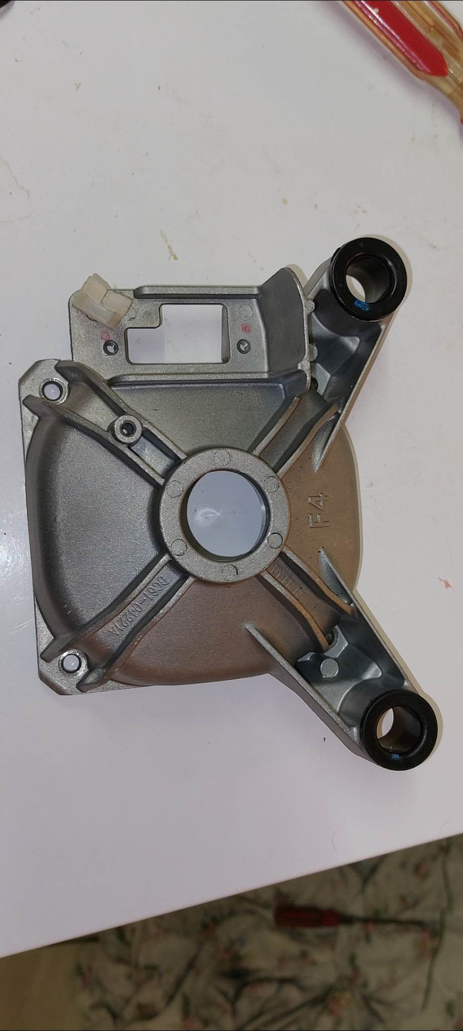

Motor all apart - come apart very easily 4 posidrive (cross) head bolts with nuts on the other end .
one thing I am concerned about is when it was altogether i was tapping the casing of the motor (front seems alloy / rear seems just tin as I was tapping with a screwdriver I was getting a terrible hollow sound , I am guessing  that in operation this is what is actually making the wash motor louder than it actually should be! - there are no vent holes at all in the motor casing - when it is all put together it is totally sealed , no air to get into the motor to cool it, and as its totally sealed I think some of the noises I am hearing is some kind of 'resonance' you know if you just got a metal tin without nothing inside and you just tap it with something and you get that hollow sound well that it what the motor sounds like when its together. and noise inside the motor would be amplified of course .
so i am pondering whether to drill some air holes into the casing like other washing machine motors have and seeing if that cuts out the hollow sound. - that would be the next step I think or try and attack that issue before I put it back in the machine.
the 2 internal bearings are absolutely perfect - very free running , they are sealed bearings in any case so even if they were dry I wouldnt be able to grease them up if I wanted to ... but I dont anyway because they are fine - i cannot think of anything else that would make the motor any noisier than it is. I might try putting some grease on the magnets and the armature - absolutely dry, no grease whatsover on them

Motor all put back together and back in machine .... still works (which is a plus) -
I put some grease inside all around the bearings (even though they are a sealed) and on the end of the shaft and drilled a few air holes in the casing for good measure
hasn't made one iota of difference what I did ... well OK it's marginally a bit quieter - havent had it spinning at top speed so maybe that sounds better. .

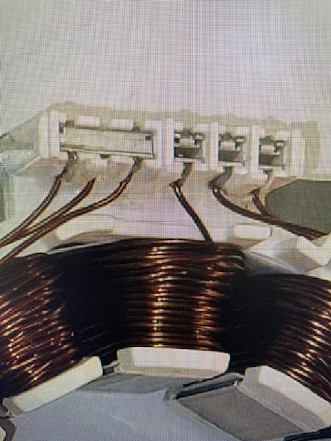

I didnt see any TOC on the coils when I had it all apart I wonder what would happen in that situation if motor seized and wash still trying to turn on that motor then? would the coils just heat up and burn out I wonder of just burn out some component on the motor PCB?
Link to comment
Share on other sites
Yes to be fair, I would normally expect to be able to hear and feel if the bearings were dodgy, though maybe it's something that only occurs at high speed. I've even had cases where the bearing is slightly loose inside the motor frame and the outer bearing spins round under high speed.
Regarding the TOC on the field coil, is this it on the left?

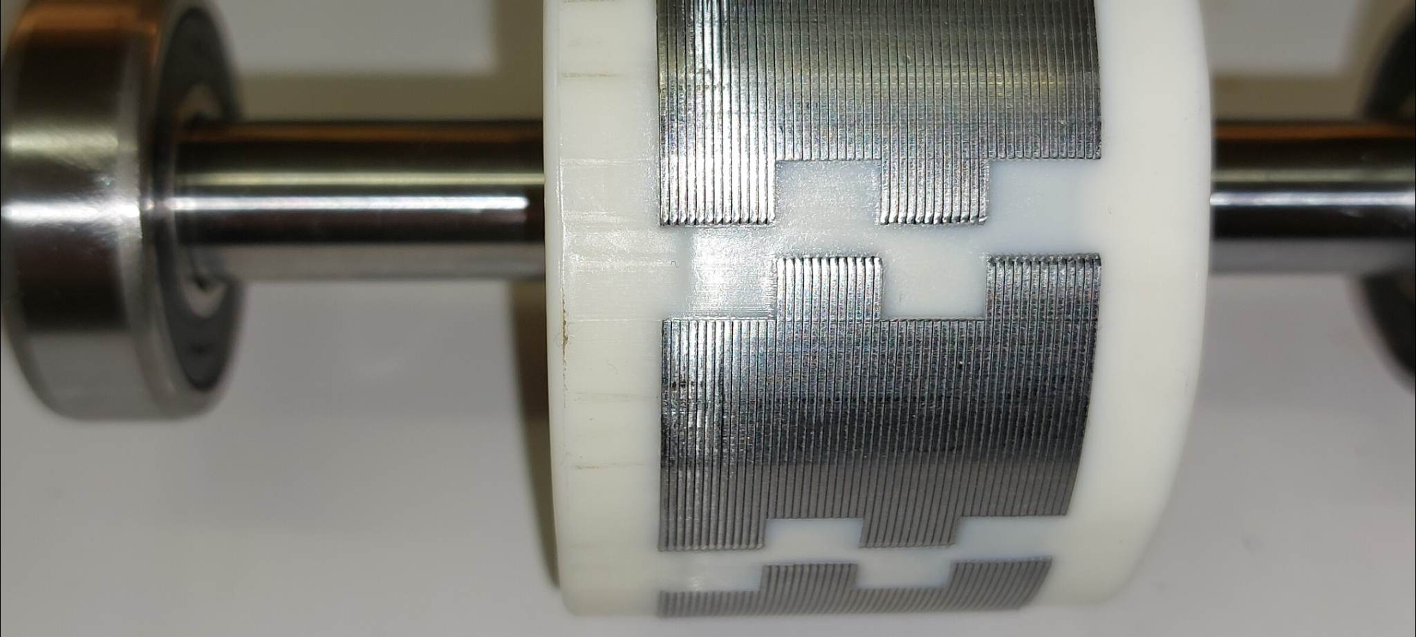

could the different design of the armature affect the sound of the motor at all?
The armature stack in the diagram picture is all metal and in reality the armature is white plastic with metal parts in it  :
Link to comment
Hello Andy. I wouldn't expect the rotor to make any noise at all (I think an armature is one with carbon brushes and copper segments). The only thing I could imagine being "wrong" with a rotor is it somehow being out of balance. That would cause a lot of vibration but not that kind of noise.
