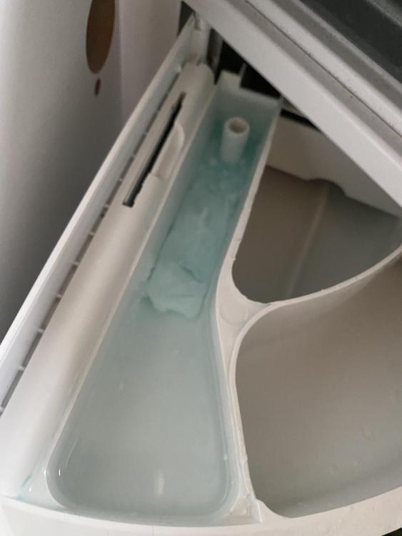

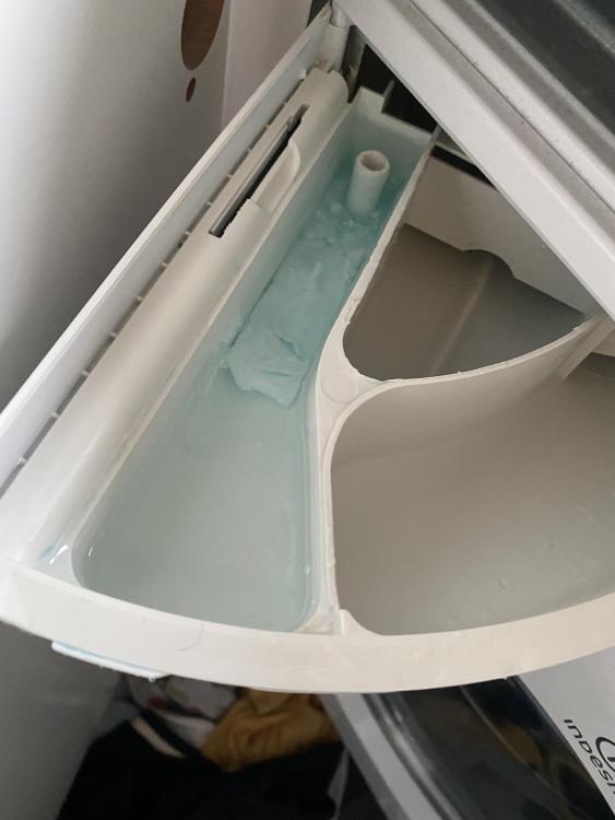

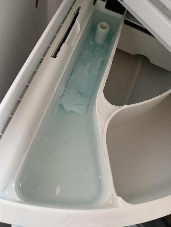

Faxanadu Posted April 19, 2022 Report Share Posted April 19, 2022 Hi everyone, I hope you can help. I own an Indesit integrated washer dryer (IWDE146). It’s been serving me well for the past four years. Lately, I have noticed that the fabric conditioner slot remains full of water / half dissolved conditioner after every wash. The liquid simply sits in there. Sometimes it leaks out of the machine as it gets too full. In the past, I have fixed this issue by cleaning it, unclogging any possible blocked areas, and putting it back. This time around, I have followed the same procedure, cleaned it thoroughly, however water still sits within the slot, with fabric conditioner doesn’t seem to disssolve. I was wondering if you had a recommendation as to how to fix this issue. Thanks very much in advance. Link to comment Share on other sites More sharing options...

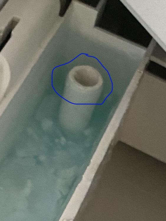

Root Admin Whitegoodshelp (Andy) Posted April 19, 2022 Root Admin Report Share Posted April 19, 2022 Hi. It looks like there is a cap missing that should fit over the tube at the back? Need a repair or spare parts? Book a Repair | Buy appliance spares (Cheapest prices guaranteed) Warning: Read this before attempting any diy repairs. No representations or warranties are made (express or implied) as to the reliability, accuracy or completeness of advice. I can't be held liable for any loss arising directly or indirectly from the use of, or any action taken in reliance on, any information on this website, which is given free of charge and in good faith. Link to comment Share on other sites More sharing options...
Root Admin Whitegoodshelp (Andy) Posted April 19, 2022 Root Admin Report Share Posted April 19, 2022 Here is my article on the subject , which explains how it should work fabric softener compartment full of water Need a repair or spare parts? Book a Repair | Buy appliance spares (Cheapest prices guaranteed) Warning: Read this before attempting any diy repairs. No representations or warranties are made (express or implied) as to the reliability, accuracy or completeness of advice. I can't be held liable for any loss arising directly or indirectly from the use of, or any action taken in reliance on, any information on this website, which is given free of charge and in good faith. Link to comment Share on other sites More sharing options...

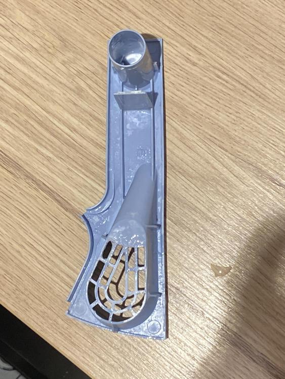

Faxanadu Posted April 19, 2022 Author Report Share Posted April 19, 2022 11 minutes ago, Whitegoodshelp (Andy) said: Hi. It looks like there is a cap missing that should fit over the tube at the back? Hi Andy, thank you for your reply and helpful link to your guide. There is indeed a blue part, could this be the cap (pic attached)? I’ve only just removed it to take the pictures (and also to see if water would go away with cap off). Cap has always been on and problem arose nonetheless. I have cleaned the tray recently, removing every blockage I could see, every spot of mould. In the past, this helped sort the issue right away. this time around, the overfilling doesn’t seem to have been resolved, despite me cleaning the tray and blue part #puzzled Link to comment Share on other sites More sharing options...
Root Admin Whitegoodshelp (Andy) Posted April 19, 2022 Root Admin Report Share Posted April 19, 2022 Hi. Yes that’s it. With the cap on properly it shouldn’t be possible for water to be left in the compartment unless it’s just a mm or so left. Please read my article which explains it all and also try the under a running tap test it describes. Need a repair or spare parts? Book a Repair | Buy appliance spares (Cheapest prices guaranteed) Warning: Read this before attempting any diy repairs. No representations or warranties are made (express or implied) as to the reliability, accuracy or completeness of advice. I can't be held liable for any loss arising directly or indirectly from the use of, or any action taken in reliance on, any information on this website, which is given free of charge and in good faith. Link to comment Share on other sites More sharing options...
Root Admin Whitegoodshelp (Andy) Posted April 19, 2022 Root Admin Report Share Posted April 19, 2022 However, if all the water drains out properly under the tap test, and it’s not pure water left, and is half dissolved fabric softener, then the problem is more likely to be very poor water pressure not flushing the softener out properly, or maybe the water isn’t being flushed into the softener compartment. Need a repair or spare parts? Book a Repair | Buy appliance spares (Cheapest prices guaranteed) Warning: Read this before attempting any diy repairs. No representations or warranties are made (express or implied) as to the reliability, accuracy or completeness of advice. I can't be held liable for any loss arising directly or indirectly from the use of, or any action taken in reliance on, any information on this website, which is given free of charge and in good faith. Link to comment Share on other sites More sharing options...
