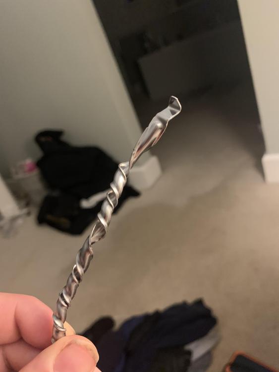

Hi there. I found a stainless steel strap (see attached photo) approx 10mm wide and 150 mm long buried in a load of dried clothes within our Hotpoint tumble dryer. It may have come from the dryer or alternatively was wrapped  up in the clothes from the wash in our Indesit washing machine. There was also a very small screw in there. There is a screw hole in one end, and the strap is twisted like a corkscrew at the other end and has sheared off at the other screw hole end suggesting it's been twisted then torn off during a spin cycle. I've looked in the drums of both machines and can see where it could of come from inside, but can't see how it would have got inside the drum. Any ideas? Could I still run either machine without the strap or attempting a repair? Many thanks.

I was wondering if it could be a heater bracket holding the element in place. It doesn't look like the thickness of metal normally used in washing machines though. But it seems unlikely someone would have had this in their pocket so it must have come form the washing machine or dryer. Do not leave the washing machine running until you are happy it isn't going to leak. Test it with a normal load of washing inside and listen out for knocking or tapping noises. If it were me I would disconnect from the mains, take off the top and back panel and have a good look inside first to see if you can see anything.

I had Hotpoint visit to inspect my machine as it was still under guarantee. I had noticed that any program other than the 30 or 60 minute cycles would stop after about 15-20 minutes.
Their engineer identified that a sensor was missing that told the machine if the clothes were dry or not. He said it was a strip of metal and asked if I had found one in the dryer recently.
Problem solved. Parts ordered and now awaiting them to come back and fit them.

does indeed look like the moisture sensor bar , at the bottom of the drum , inside the drum itself - imaging that tearing off like that. Pretty bad. All i can think is that a bit of clothing catches on the metal strip sensor and then must 'pull' it out of the sensor bar housing cover . pretty poor design in that respect . I have just bought a new BEKO vented tumble dryer with sensor drying and I have noticed on these new ones they have removed the moisture bars totally from inside the drum altogether and have now put a sensor for detecting the moisture right underneath the lint/fluff filter now. Harder to get to, to clean, but no change of it getting ripped off and caught up in your washing though!
