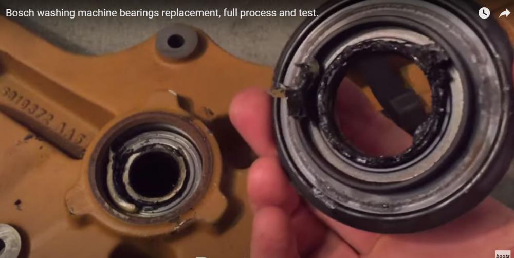

hi Andy
are you sure it is not ball bearings leaking oil in the drum  i have bosch WVG30461GB  5 years old
i have the same black marks like those jeans.  i am going to remove  boot gasket soak in bleach
if that does not work i am going to try and split the drum change bearings
i would need to get another 5 years for this work.  bosch wont sell bearing where would i get bearings and seal
and what is the best glue for this job
Hi wdc.  Bearings shouldn't leak into the drum. They are sealed in the back of the drum and protected by a seal in front. They don't have oil in them either, just a bit of yellowish grease. If anything inside the bearings could get into the drum then water would also easily get into the bearings. This would quickly wash away grease and make the drum pretty rumbly and noisy.
If manufacturer doesn't supply drum bearings, then they are designed to be unrepairable. I would say it's not worth trying to circumvent that. You would need to replace not only the bearings but the seal if front of them that keeps out the water. If they are in a sealed drum you are unlikely to be ble to buy such a seal.
Also you would have to try and seal the two drum halves back together when it's not designed to be done and the drum bearings could be difficult or even impossible to knock out.

6 hours ago, wdc said:
black grease bosch bearing
Thanks. There's no need for black grease 😂 But even so it shouldn't be possible for grease from the bearings to get into the drum because they are sealed from the drum and water.
If the drum bearing seal fails, then potentially it could, but the weight of all that water should force any grease out through the back of the drum where there are two drain holes designed for that job.
So if the drum bearing has failed and grease could get out, a mu h bugger problem would be that water would run into the bearings. This should cause a rapid deterioration of the bearings with them becoming noisy and eventually collapsing.
But if there is black grease in there then it can't be totally rules out as a source.
