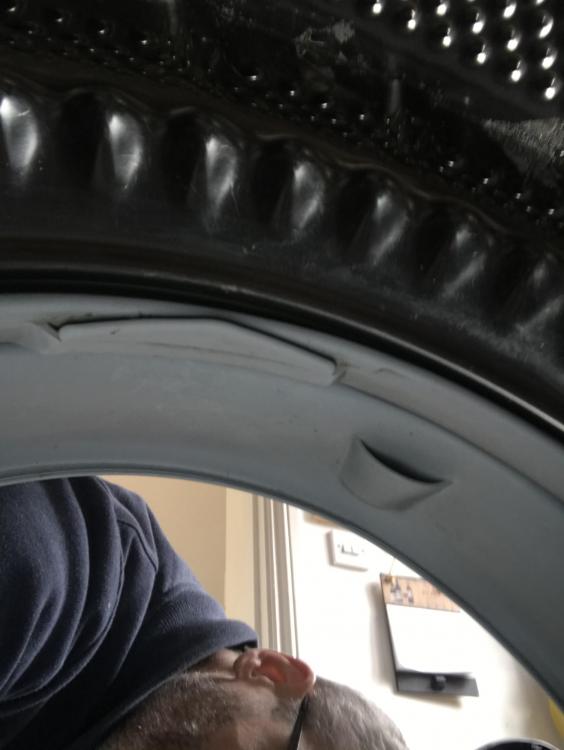

Take something like a white cloth, preferably made of the same type of material that is being affected. Then drag it firmly all around the door seal between the lip of the drum and the gap. Try to rub it all the way around, and try to drag it on the lip of the outer drum too. See if you can get any marks that correlate to the marks you are having trouble with. Inside a washing machine this is the only place that clothes could get dragged against something. Otherwise they are totally contained within the inner drum. With some fabric such as cotton's, when they go on a fast spin the laundry does get pressed through the holes in the drum and in certain circumstances can pick up marks. However these marks will be small spots correlating with the holes in the drum. Apart from these two possibilities it is not possible for laundry to be physically marked by anything else.

Try dragging and rubbing a white cloth all the way around the door seal under the lip of the seal to see if anything is there. Especially in washer dryers at the top. Also carefully secs in the door seal near the door all the way around and underneath.

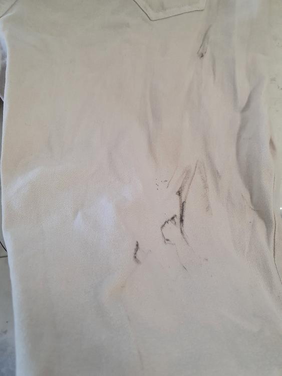

Hi all, I had the "black streaks" problem for a long time and had unsuccessfully tried all the tips mentioned above but finally found a solution about a year ago. If you ensure that in the spin cycle, the Rotations Per Minute - RPM - is always below 1100 RPM, then there'll be no more black streaks. It seems the agitation of a really fast spin cycle (in my case, a Miele where 1600 RPM is the standard setting on the cotton cycle) either projects any black gunk onto the clothes from crevices in the machine or propels the clothes into the crevices where the black gunk is. I now choose a cycle that has a lower spin RPM or manually turn down the number of RPM to 1000 or 1100 per minute. It's an extra manoeuvre each time, but it's better than the dreaded black streaks. Obvs you still have to clean rubber rings etc fairly regularly.
Hope this helps
  • 2 months later...
Have had same issue with black streaks on clothes for a long time, just like pictures posted by microelk.  Have a top load whirlpool machine. Thoroughly cleaned the machine and black streaks continued to return. Was ready to purchase a new machine.  Found a solution. Read the installation drain system instructions. Have now changed the way we drain the wash machine. Switched the drain system to laundry tub drain system as per manual instructions. Believe the problem was that we never had a Siphon Break kit installed with the previous drain system when first installed.  Since then, laundry has no black streaks!!
