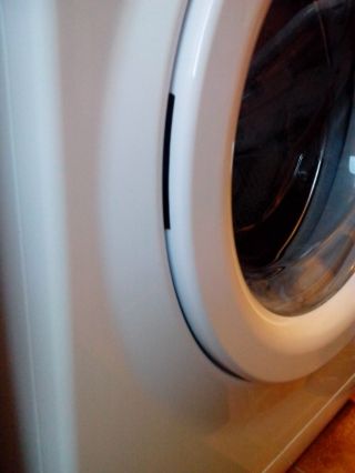

https://i1178.photobucket.com/albums/x361/Andyr_45/DSC_0039.jpg
  • Cut/Filed extra bit of plastic on door fascia where hinge is to allow porthole door to open back further
