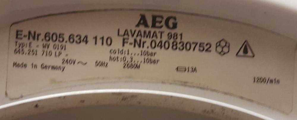

  1. I have two AEG Lavamt 981 washing machines which are still running. One is in neeed of a drum bearing change but I am struggling to obtain a replacement seal. I have tried Ransome Spares & a couple of other companies without luck. They claim not to have the necessary machine data, plate below. The twin lip seal is for a 35mm dia shaft & fits into a 78mm bore in the spider. There is an outer lip of 87mm diameter which contacts the steel outer drum. The original is Corteco 45-78/86-10.5/15 BAESLSFX7 It seems a shame not to repair this machine for the sake of an oil seal. These machines are so well made, they still work & look great after 30+ years. Please can anyone suggest a supplier or an alternative seal that would fit? Thanks in advance.
