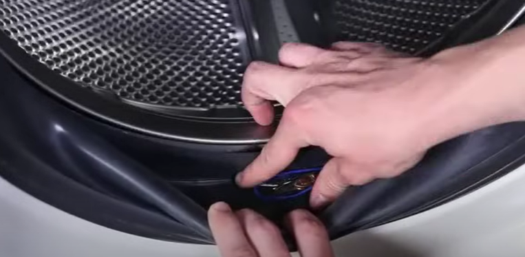

hello @Anya - what you could try and see is if the 3 little drain holes are clear/clean at the bottom of the door gasket and make sure the water is draining freely through them. I am just thinking maybe water could be 'pooling' up at the bottom of the door gasket and as you open the door it overflows down the front of the machine:
