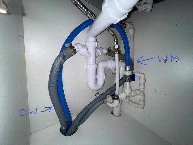

Roscoe Posted November 19, 2023 Posted November 19, 2023 Hi Folks. Our x3 month old AEG washing machine has an unfortunate damp smell coming from inside the drum. I think it might be my fault, having found Whitegoodshelp(Andy)'s link https://www.whitegoodshelp.co.uk/smells-caused-plumbing-faults/ in another thread regarding a U-bend in the drain pipe. Thought I'd check first before deciding what to do next. Picture below is the current set up, (self-install) includes dishwasher drain pipe marked 'DW' and Washing machine marked 'WM'. No U-Bend. Is this causing the bad smell and if so how do I go about fixing it based on my current under sink drain/pipe set up. Also, am I too late and potentially damaged my machine with this set up as the smelly waste water poured down the sink can run down the drain hose into the washing machine. ?? Any advice or assistance would be appreciated.
Root Admin Whitegoodshelp Posted November 19, 2023 Root Admin Posted November 19, 2023 Hi Roscoe. Yes the drain hoses are badly installed. It's possible that dirty water from the sink could run down the drain hoses into the machines. I would loosen both the washing machine and dishwasher's drain hose connections on the U-bend and turn the spout that the hoses push onto around, so that the spout points upwards instead of down. You will need to pull more of the drain hoses through. The drain hoses need to go up 3 or 4 inches before going down and will most likely need to be tied using string or cable-ties. Ideally the end of a drain hose should be like a shepherd crook that goes up, around and then down. That makes it impossible for any water going down the sink to get up, over and down the drain hoses. Roscoe and MelS 2 Need a repair or spare parts? Book a Repair | Spares4Appliances WARNING: Read this before attempting any diy repairs. No representations or warranties are made (express or implied) as to the reliability, accuracy or completeness of advice. I can't be held liable for any loss arising directly or indirectly from the use of, or any action taken in reliance on, any information on this website, which is given free of charge and in good faith.

Roscoe Posted November 19, 2023 Author Posted November 19, 2023 (edited) Many thanks for the responses, guys. Both dishwasher and washing machine hoses are at their absolute max stretch. I'm therefore thinking of picking up one of these to give me that extra length, at least for the washing machine, (the dishwasher doesn't appear to haver a problem), and the ability to create a U-Bend - https://www.amazon.co.uk/sourcing-map-Washing-Machine-Extension/dp/B0B7F33RH5/ref=sr_1_1?crid=3O7UTOXJ4NRKN&keywords=SHORT+DRAIN+PIPE+HOSE&qid=1700412110&sprefix=short+drain+pipe+hose%2Caps%2C96&sr=8-1 Edit: or perhaps I could get two of these and do both. https://www.ebay.co.uk/itm/292900884280?chn=ps&_trkparms=ispr%3D1&amdata=enc%3A18f6H32DGQ0OGyuu_Z6YAkg21&_ul=GB&norover=1&mkevt=1&mkrid=710-134428-41853-0&mkcid=2&mkscid=101&itemid=292900884280&targetid=1816459697165&device=c&mktype=pla&googleloc=1007325&poi=&campaignid=19097601017&mkgroupid=152525099668&rlsatarget=aud-1657461043188:pla-1816459697165&abcId=9303862&merchantid=101483731 If this is a bad idea, please let me know. Edited November 19, 2023 by Roscoe
Root Admin Whitegoodshelp Posted November 19, 2023 Root Admin Posted November 19, 2023 Yes that’s the answer. andyr12345 1 Need a repair or spare parts? Book a Repair | Spares4Appliances WARNING: Read this before attempting any diy repairs. No representations or warranties are made (express or implied) as to the reliability, accuracy or completeness of advice. I can't be held liable for any loss arising directly or indirectly from the use of, or any action taken in reliance on, any information on this website, which is given free of charge and in good faith.
Root Admin Whitegoodshelp Posted November 20, 2023 Root Admin Posted November 20, 2023 The second one looks potentially too thin? If the first one is the right size diameter as shown in the photos I’d get 2 of them. Need a repair or spare parts? Book a Repair | Spares4Appliances WARNING: Read this before attempting any diy repairs. No representations or warranties are made (express or implied) as to the reliability, accuracy or completeness of advice. I can't be held liable for any loss arising directly or indirectly from the use of, or any action taken in reliance on, any information on this website, which is given free of charge and in good faith.
MelS Posted November 20, 2023 Posted November 20, 2023 (edited) 19 hours ago, Whitegoodshelp (Andy) said: The drain hoses need to go up 3 or 4 inches before going down and will most likely need to be tied using string or cable-ties. Ideally the end of a drain hose should be like a shepherd crook that goes up, around and then down. That makes it impossible for any water going down the sink to get up, over and down the drain hoses. Definitely tie it up, if you get a partially blocked sink trap, the weight of water backing up the drain hose is likely to make it droop if it is not secured. Had that happen with my dishwasher years ago after we installed a new kitchen. I now have the drain hose secured by a cable tie over a cupboard hook just below the worktop. If the smell doesn't completely go after doing the maintenance clean, you could either use an oxygen bleach (eg Vanish), or a laundry sanitiser product with your regular detergent, or else use a powder detergent that has oxygen bleach in it (most powder detergents do as standard), either of which will kill bacteria in your wash and help clean the machine and rid it of smells. Edited November 20, 2023 by MelS typos andyr12345, Roscoe and Whitegoodshelp 3
Roscoe Posted November 20, 2023 Author Posted November 20, 2023 6 hours ago, Whitegoodshelp (Andy) said: The second one looks potentially too thin? If the first one is the right size diameter as shown in the photos I’d get 2 of them. Yeah the first one came from Amazon about 30 minutes ago. The second one was from China and long delivery. Agreed on the thickness. Installed. Excuse the poor cable management. 😆 I've popped some Dettol Machine wash in and running a 60 degree wash as instructed. Fingers cross this starts to solve the problem and the smell disappears over time. Yeah I think I'll get a second one for the dishwasher drain pipe. Whitegoodshelp 1
