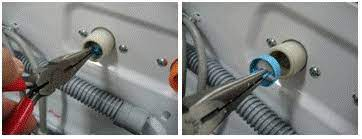

hi @Superuser2000 - have you inspected the inlet filter or both inlet filters (if it is a hot and cold fill washing machine) ?  - if just a cold fill then there is just one filter to check for dirt/limescale:
does your washing machine have hot and cold fill by the way? or is it just cold fill?
I am just thinking about if it is slow to take in water at the start of the wash the hot water inlet valve could be faulty / filter needed cleaning but the cold water inlet valve may be clean and that is why it takes in water OK at rinse time.
