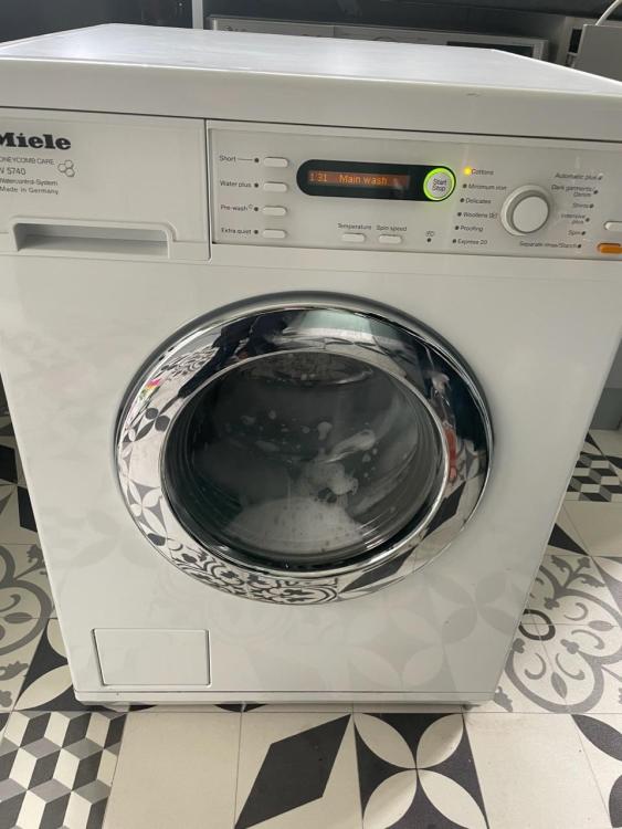

Asparagus Posted April 21 Report Share Posted April 21 We got this second hand Miele. Sadly on some cycles the timer stops and cycle carries on until stopped. There’s also a bit of unusual sound on spin, it’s not very loud and doesn’t occur all the time. Kinda like there’s something loose there maybe. Any idea if this can be fixed and how much it would cost? Hopefully not as much as new machine What’s the best to use for descaling? Can I use critic acid ? Link to comment Share on other sites More sharing options...
Root Admin Whitegoodshelp (Andy) Posted April 22 Root Admin Report Share Posted April 22 Hi. That looks like a W370 or similar. Excellent machine but quite old. Some cycles have creaseguard function where after the last spin the drum keeps revolving every so often to prevent creasing. Could it be that? Have you got the manual? Need a repair or spare parts? Book a Repair | Buy appliance spares (Cheapest prices guaranteed) Warning: Read this before attempting any diy repairs. No representations or warranties are made (express or implied) as to the reliability, accuracy or completeness of advice. I can't be held liable for any loss arising directly or indirectly from the use of, or any action taken in reliance on, any information on this website, which is given free of charge and in good faith. Link to comment Share on other sites More sharing options...

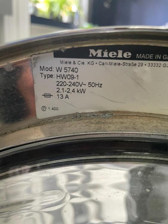

Asparagus Posted April 22 Author Report Share Posted April 22 It stops on main wash with water inside the drum. The display shows stuck timer and says Main wash. It stops after pressing stop button twice. It says that it’s a W5740 Link to comment Share on other sites More sharing options...
Root Admin Whitegoodshelp (Andy) Posted April 22 Root Admin Report Share Posted April 22 Have you checked the pump filter? Need a repair or spare parts? Book a Repair | Buy appliance spares (Cheapest prices guaranteed) Warning: Read this before attempting any diy repairs. No representations or warranties are made (express or implied) as to the reliability, accuracy or completeness of advice. I can't be held liable for any loss arising directly or indirectly from the use of, or any action taken in reliance on, any information on this website, which is given free of charge and in good faith. Link to comment Share on other sites More sharing options...

andyr12345 Posted April 22 Report Share Posted April 22 58 minutes ago, Asparagus said: It stops on main wash with water inside the drum. The display shows stuck timer and says Main wash. It stops after pressing stop button twice. It says that it’s a W5740 Thats sounds like what a "Rinse Hold" will do on a washing machine - so you have not selected that have you? Whitegoodshelp (Andy) 1 Link to comment Share on other sites More sharing options...

Asparagus Posted April 24 Author Report Share Posted April 24 Anyway, we've checked the drain hose and there aren't any blockages there. We've put the washing machine in its place. A bit tight but the washer isn't touching anything. The only thing that worries me is that there's a ventilation vent and sometimes can get a bit cold. Not freezing cold though. Is it alright for the washing machine to live in a cold area or should we block this vent? I know that some people keep washing machines in garages. I think I must've selected rinse hold then cause I've done several loads since then without any problems. Stupid me for creating a problem where there wasn't any problem. andyr12345 and Whitegoodshelp (Andy) 2 Link to comment Share on other sites More sharing options...
Root Admin Whitegoodshelp (Andy) Posted April 24 Root Admin Report Share Posted April 24 Thanks for the update. Unfortunately when you said it stops with water inside I assumed it was just “some” water. If I’d realised it stopped with full amount of water I’d have thought about the rinse hold. Don’t worry about the vent. Ours in in a garage that gets down to freezing at times. Need a repair or spare parts? Book a Repair | Buy appliance spares (Cheapest prices guaranteed) Warning: Read this before attempting any diy repairs. No representations or warranties are made (express or implied) as to the reliability, accuracy or completeness of advice. I can't be held liable for any loss arising directly or indirectly from the use of, or any action taken in reliance on, any information on this website, which is given free of charge and in good faith. Link to comment Share on other sites More sharing options...
