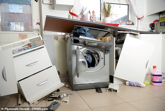

i come across this pic earlier on , on the internet. - something tells me that it went into an unbalanced spin and the machine didnt recognise it 😁
  • 1 month later...
Hi Andy. Yes it looks a little bit staged to be honest, but this sort of thing definitely happened. I wrote an article about it - Hotpoint Indesit & Hoover Candy washing machines exploding
