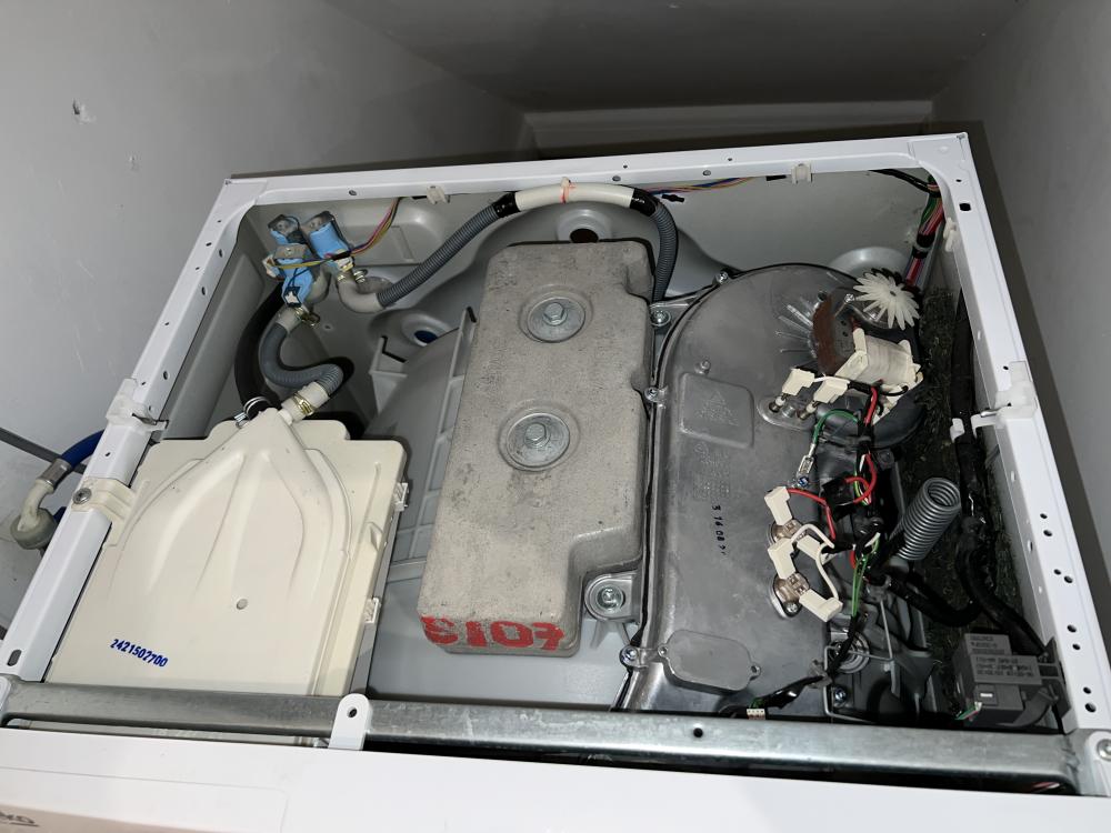

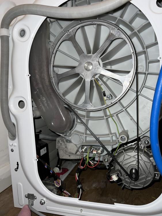

I have a combined Beko WDJ723023W washer dryer. When I use the dryer setting, the drum spins but there is no heat so my clothes stay damp. This used to happen with a previous washer dryer I had and to fix that, I would take off the top and there was a red button I could press that would click. I've opened the top and the back of the Beko, but cannot find any such button. Please could anyone help?

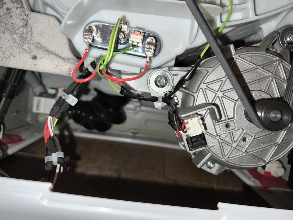

Hi there @washingmachine0800 - in this picture this thermostat / sensor is only for the wash cycle only so has no bearing on the tumble drying heat part of things. - the 2 sensors at the top are cut outs for the tumble drying.

Your washer dryer in your machine looks to have the same element at the top there in the heating box as the same kind of element you would find on a electric cooker that is inside the oven or top grill part and  (without cutting out) would just glow red (like a element in a grill) - so maybe that has just the 2 normal thermal cutouts (non resettable) at the top in the box .
I'd whip the terminals off them TOC's and check the continuity across them first as its likely i think to be one or both of them at fault possibly, then if they have continuity, the actual heating element for continuity or open circuit. - Things i can think of tripping the TOC(s) is maybe fan not blowing over the element or the element itself working .. but overheating past the allowed thermal parameter allowed by the PTC
