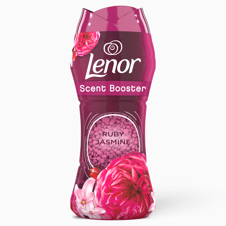

Have you tried these kind of lenor scent booster granuals as well in your wash ?
