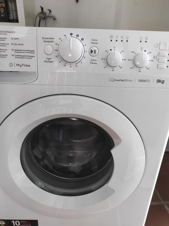

Chuzupop Posted August 1, 2022 Author Report Share Posted August 1, 2022 23 hours ago, Whitegoodshelp (Andy) said: Thanks, and good luck. I wouldn't recommend ordering any spare parts unless you have shown it is definitely faulty - so fingers crossed. Hi Andy have bought this machine, have got it home everything is inside and I cannot open the door there is no handle. Obviously a child proof lock. Any ideas? 🙈🙈🙈🙈🙈 It's an Indesit. Link to comment Share on other sites More sharing options...
Root Admin Whitegoodshelp (Andy) Posted August 2, 2022 Root Admin Report Share Posted August 2, 2022 20 hours ago, Chuzupop said: I cannot open the door there is no handle. I would assume you just pull on the door handle that's built into the door. Need a repair or spare parts? Book a Repair | Buy appliance spares (Cheapest prices guaranteed) Warning: Read this before attempting any diy repairs. No representations or warranties are made (express or implied) as to the reliability, accuracy or completeness of advice. I can't be held liable for any loss arising directly or indirectly from the use of, or any action taken in reliance on, any information on this website, which is given free of charge and in good faith. Link to comment Share on other sites More sharing options...
andyr12345 Posted August 2, 2022 Report Share Posted August 2, 2022 On 01/08/2022 at 18:13, Chuzupop said: Hi Andy have bought this machine, have got it home everything is inside and I cannot open the door there is no handle. Obviously a child proof lock. Any ideas? 🙈🙈🙈🙈🙈 It's an Indesit. @Chuzupop - try plugging it in and select 'pump out' - not spin and put the dial to no spin , hopefully it will pump out if there is any bit of water in the drum and then it will finish (might take just 2 minutes) and then you will hear the door click and then you will be able to open up the door also check when its plugged in, that the child lock is turned off. Other than that , some hotpoints and Indesit's have an emergency way to unlock the door from either taking the door kick off at the bottom of the machine , or getting to it from underneath the machine. Link to comment Share on other sites More sharing options...
