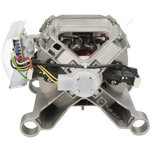

hello @Spamcan- I am going to hazard a guess if its a re-branded older Beko that it has a brush type motor and if you cannot hear a shrill when you turn drum by hand that the brushes have worn to such an extent they maybe are not even sitting on the brass segments of the motor armature at all, or the armature has so much carbon on it that you cannot hear it and have to clean the brass contacts on the armature. indication if it is really a brush type motor is that when the washing machine did work and it went into 'spin mode' did it 'shrill' loudly  or 'woosh' silently? if it shrilled then it has a carbon brush type.

worth an inspect of the carbon brushes though (if the motor is that of a carbon brush type motor)
here is the motor for a Lamona  HJA8501 - it is a carbon brush type motor:
