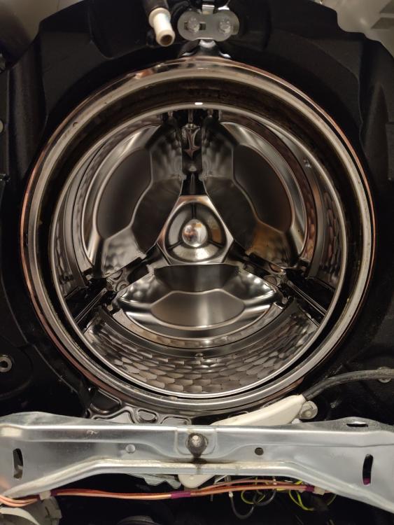

Will add a picture in a subsequent post.

That drum looks quite elliptical. That would explain why the drum is so unbalanced when spinning.  It looks bad. Has it suddenly happened or has it been noisy for a while?
Drum bearings usually have a deep rumble and when you spin the drum by hand it feels nobbled and rough. They don’t normally cause the drum to run so out of skew.
They also don’t fail so quickly and normally slowly become noisier and noisier. The Miele front drum bearing is also very large. About twice the size of ordinary ones.
It looks like the drum spider could have a problem but again the Miele drum spider is really well made. It’s almost as if the drum has been knocked out of true. Has anything got inside it to cause it to become out of shape or any sign of any physical damage to it?
No there doesn't seem to be anything inside, and the drum is still in perfect shape.
How would one even begin to understand what the issue is?
Is it worth me getting Miele out to look at it?
If you look at the gap between the top of the drum and the outer tub at the top as the drum spins (on the video) the gap changes drastically by about 2 inches. The drum looks completely out of true.

If it is shaking about like in the video with nothing in the drum then the drum is completely out of true and would probably need replacing. Have you checked inside the sump hose and pump filter in case any object that could have knocked it out of true can be found?
