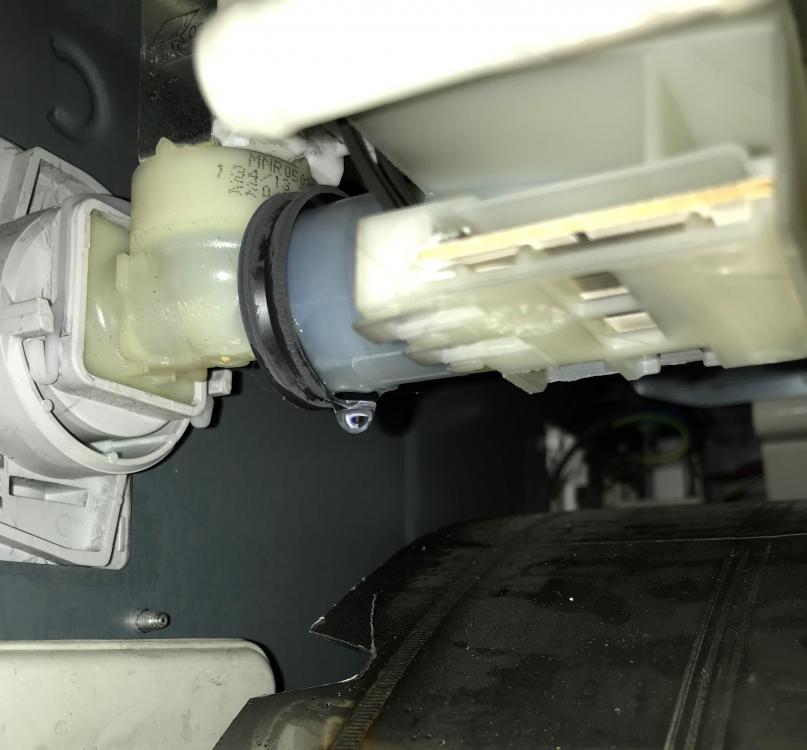

JoeP Posted September 11, 2022 Posted September 11, 2022 (edited) Hi - I have exactly the same issue. Water leaking from the black rubber seal. I cleaned the joint and put some silicone on which has improved things slightly - but still leaks when the machine fills. Were you able to get a spare part - and did it work ? Pic below from the side on the machine (side panel removed so I could work out where the leak was coming from) Thanks Joe Edited September 11, 2022 by JoeP
Root Admin Whitegoodshelp Posted September 12, 2022 Root Admin Posted September 12, 2022 This is unusual to find several people have the same fault on a Miele washing machine. It may well be that there is an issue that Miele needs to resolve. If you are sure that the water is coming from this sale, and not dripping on it from somewhere above, then the seal really needs replacing if you can't stop it with sealant. Need a repair or spare parts? Book a Repair | Spares4Appliances WARNING: Read this before attempting any diy repairs. No representations or warranties are made (express or implied) as to the reliability, accuracy or completeness of advice. I can't be held liable for any loss arising directly or indirectly from the use of, or any action taken in reliance on, any information on this website, which is given free of charge and in good faith.

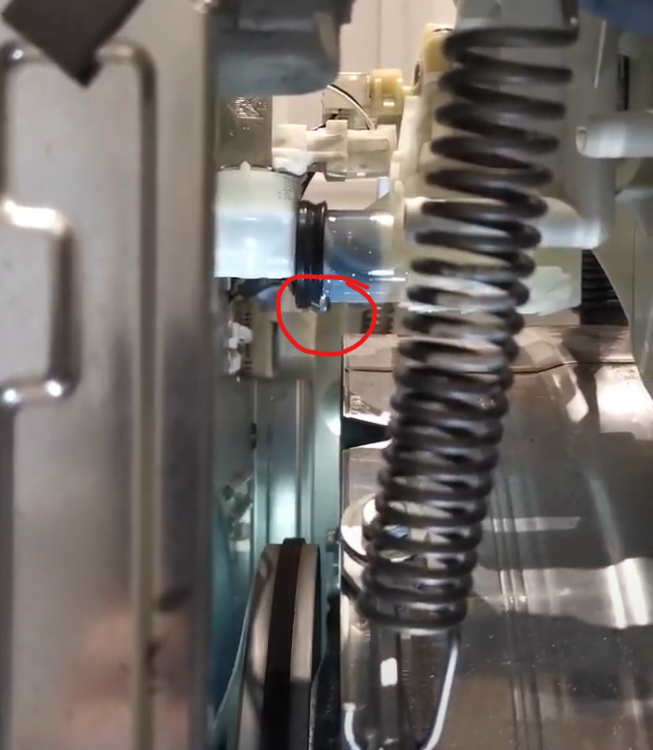

Elliott Posted September 22, 2022 Posted September 22, 2022 I finally figured this out and fixed our washer! This is what I tried: - Lubricating the gears in the water path control unit. That seemed to work briefly, but then leaked again. - Replacing the big rubber seal (you can order it from Miele), but it leaked again. - Adding a rubber O ring to prevent the seal from shifting backwards. But it still leaked! After all that I finally ordered a new water path control unit from Miele (call on the phone). That seemed to work briefly but then I had issues where it would fill forever until I turned it off. Finally I realized the problem is the cold water valve, I replaced that and the washer works like new with no leaking. What seems to happen is that the cold water valve goes bad, and then it gets stuck in the open position when the water path control unit is not in a mode where it wants cold water. Internally it contains a disc that has various inputs and outputs for water and a gear that spins to select which two to connect. One of the outputs is closed off for when there should be no water entering. If the cold water valve stays open when the disc selects the "off" position then the water pressure causes that big black seal to shift backwards and then it leaks. If you're having this problem you should: (1) First replace the cold water valve ($59). It might be getting stuck open. (2) If it still leaks then replace the water path control unit ($220). It might be calling for cold water when the disc is in the wrong position. You can look up your model and find the part numbers in the diagrams at Miele website, sometimes you have to call them on the phone to order the parts. Note: You can also order just that black rubber seal ($8), but when you have this leak it's more likely to be the problem above. Whitegoodshelp 1
