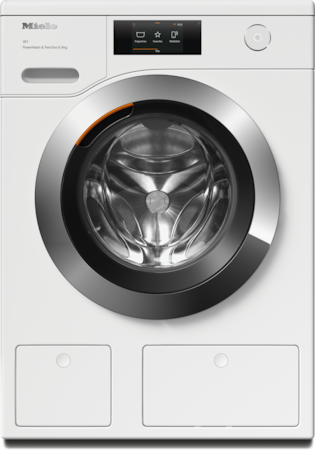

andyr12345 Posted July 9, 2022 Report Share Posted July 9, 2022 (edited) (when I win the Lotto LOL) I have my sights sets on the nearly 2 grand miele W1 with touchscreen , wifi and autodose - looks like a really nice washing machine https://www.miele.co.uk/e/w1-front-loader-washing-machine-wcr-860-wps-pwash-2-0-and-tdos-xl-and-wifi-lotus-white-10994810-p https://media.miele.com/images/2000018/200001856/20000185683.png Edited July 9, 2022 by andyr12345 Link to comment Share on other sites More sharing options...
