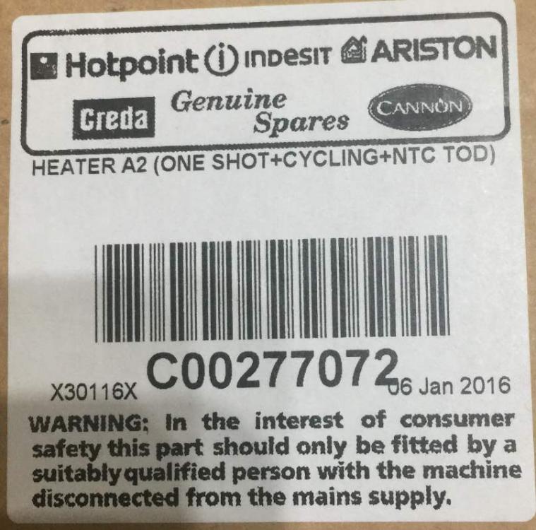

I bought a couple of replacement thermostats off eBay, fitted these but no change, the dryer still didn't get hot.  I did a bit more digging and it suggested I replaced all 3 thermostats rather than the 2 I had already replaced.  In the end I decided to buy the entire heater unit complete with thermostats.
Before this arrived I was playing around with the dryer and I found it did get warm when using one of the Set and Forget programmes, i.e. 1 Ready To Wear 2 Cottons Cupboard Dry, it only doesn't work when you try and set using one of the number, i.e. 60.
The replacement heater unit arrived and I fitted it yesterday, anyway there is no change it still only works on the Set and Forget programmes.

Hi. Not drying only points to thermostats as just one possibility. It's a shame you wasted time and money on the heating element as it's one of the parts that can be easily tested with a meter to see if it's faulty or not. If a dryer isn't heating it can be a problem with the pcb, a connection or wiring fault, a stat, a cut-out or the element. You have to trace the fault with a continuity test meter.

Also :) If the heater works on some setting but not others it surely means all the cut-outs (TOCs) and the element and wiring are OK. To be honest I wouldn't risk buying any more parts speculatively although I can imagine you not wanting to get beat by it.
