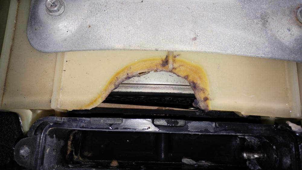

I too have had the same issue but I have found the root cause to be the gaping hole in the drum enclosure underneath the dryer heater(see attached pic) allowing water to be sprayed out and covering the pressure switch and the mains filter and blowing the fuse. This looks to me like it is a design fault.. The heat shield isn't large enough.
Hello PendlePete. That looks bad. It's hard to judge from a photo and without being able to examine the machine but that's definitely something that should not happen. It's possible there is a design fault if the plastic is exposed to excess heat, or possibly something went wrong when it was manufactured.

I decided that if I can't have my £680 LG Washer Dryer then neither can anyone else and proceeded to strip it to the bone (childish I know, but extremely therapeutic if not very expensive). Then as I was doing this the real fault appeared to say "Hello!"
(see pic) - at this point many, many 'special' engineering words were said out loud in Punjabi as well as English.
Well it was down to an extremely poor design by LG and has put me off buying any of their fanciful products in the future due to their sheer lack of after sales service and bad attitude.

I had the exact same issue. The RCD tripping was caused by water splashing out here and hitting the filter coil. Replaced that with a part from espares and I bought a replacement drum for 23 GBP on eBay and its been fine ever since.

hi guys my one hasn't gone as far as making a hole but i noticed the burnt mark on the same casing. LG engineer came out the guy was useless lucky I had taken pictures myself which he ended up using to writing his report.
LG have offered £70 odd pounds to settle this due to amount of yrs I have owned washer dryer (5 and half years). But im not accepting because like most im sure will agree this is a design fault you can clearly see the heat shield is not long enough.
