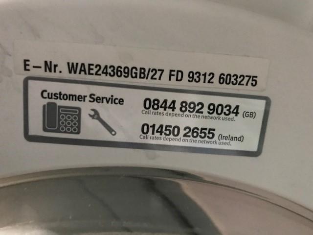

Pistol Posted September 17, 2018 Report Share Posted September 17, 2018 Thanks Andy, I definitely will be testing the element with a multimeter before ordering anything. My machine is a WAE24369GB/27. I don't seem to see that exact E-Nr on any of the replacement elements I've looked at so far; as long as the WAE24369GB bit is correct, do the last two digits matter? I found this video showing someone taking a similar Bosch to mine to bits, that should help me get to the element to test it. While I'm at it, I'm tempted to replace the brushes in the motor - the brushes wearing down to nothing was what did for our last Bosch, and we've had this one for four years, doing quite a lot of washing with it. How hard is it to replace the brushes? Link to comment Share on other sites More sharing options...
Root Admin Whitegoodshelp (Andy) Posted September 18, 2018 Root Admin Report Share Posted September 18, 2018 I don't think they matter unless specified Pistol 1 Need a repair or spare parts? Book a Repair | Buy appliance spares (Cheapest prices guaranteed) Warning: Read this before attempting any diy repairs. No representations or warranties are made (express or implied) as to the reliability, accuracy or completeness of advice. I can't be held liable for any loss arising directly or indirectly from the use of, or any action taken in reliance on, any information on this website, which is given free of charge and in good faith. Link to comment Share on other sites More sharing options...

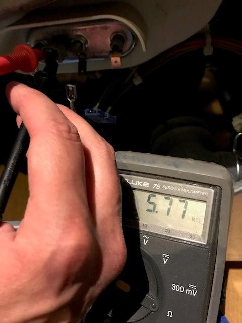

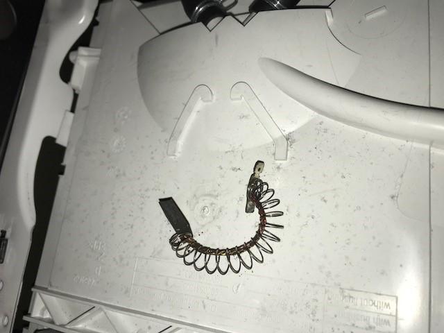

Pistol Posted September 19, 2018 Report Share Posted September 19, 2018 Right, got the machine stripped down last night and I'm pretty sure it's the element. Tested it with a multimeter on the resistance setting and it just read "OL". Tested the thermostat too, and that gave a reading. So I think that means the element is shot, correct? (I'm going to try and attach photos showing the test, just to confirm I'm right!) I also took one of the motor brushes out and it looks pretty short to me, there's about 1.5cm left. So I think it would be prudent to replace those while I've got the machine in bits. Access to the other brush looks impossible without removing the motor - I think if I take the drive belt off, undo the bolts at the back, and drop the motor to the floor under the machine, I should be able to get in though. Do you sell the parts I need, Andy? Heating element, motor brushes and I guess a commutator cleaning stick? Link to comment Share on other sites More sharing options...
Root Admin Whitegoodshelp (Andy) Posted September 19, 2018 Root Admin Report Share Posted September 19, 2018 Yes. Please try Ransom Spares. The link should be in my signature below every post. Can you confirm that it is visible for other members please? I have just made efforts to make it stand out a bit more. You would need to take off the motor to replace the brushes properly and clear out the carbon dust. A com stick shouldn't be necessary, especially if the brushes haven't been allowed to wear out and spark excessively. However, the photo makes the brush look plenty big enough. But if it is only 1.5 cm it might make sense whilst you're at it. Try to make sure you use genuine carbon brushes. They are more expensive but cheap carbon brushes used to cause a lot of damage because they were too soft and created too much carbon dust. I don't know if they've improved recently but I would always use the genuine ones. Regarding the heating element the reading across the 2 terminals should be something roughly between 20 and 50 ohms. If it is open circuit it has definitely gone. Need a repair or spare parts? Book a Repair | Buy appliance spares (Cheapest prices guaranteed) Warning: Read this before attempting any diy repairs. No representations or warranties are made (express or implied) as to the reliability, accuracy or completeness of advice. I can't be held liable for any loss arising directly or indirectly from the use of, or any action taken in reliance on, any information on this website, which is given free of charge and in good faith. Link to comment Share on other sites More sharing options...

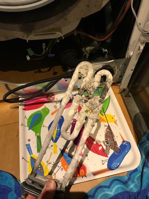

Pistol Posted September 21, 2018 Report Share Posted September 21, 2018 Well I guess it's clear what happened here. Don't neglect your hot maintenance washes folks!! Glad I opted to replace the brushes too, compared against the replacement ones you can see they were about two thirds gone in four years - hopefully we'll get another four at least out of it now! Did a boil wash this morning to flush the crud out, all seemed to go OK - thanks all whose advice I found invaluable! Whitegoodshelp (Andy) 1 Link to comment Share on other sites More sharing options...
