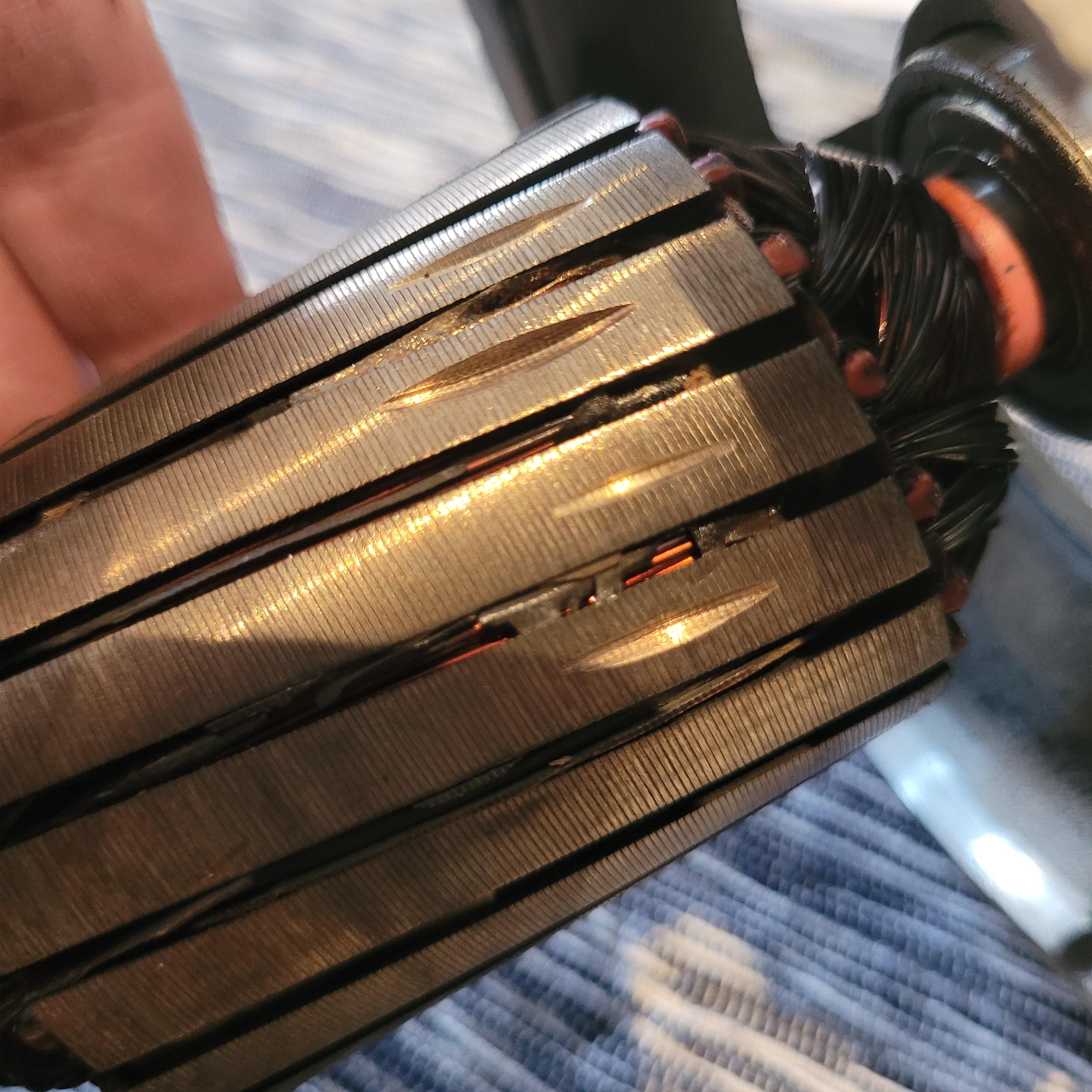

  5. Yeah, I swapped that one out as well, allthough it was working finde. But man - how did you see the crack? 🕵️‍♂️ And you are right, the red marked is for the dryer!

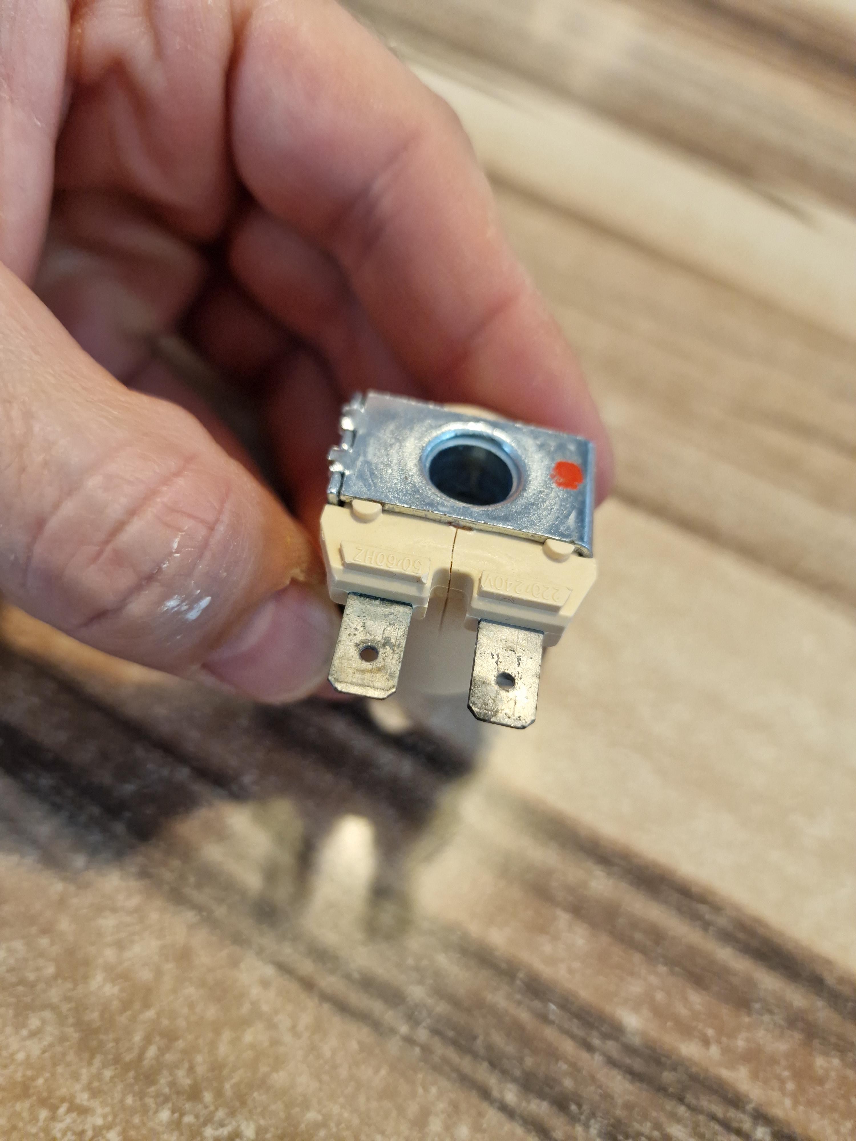

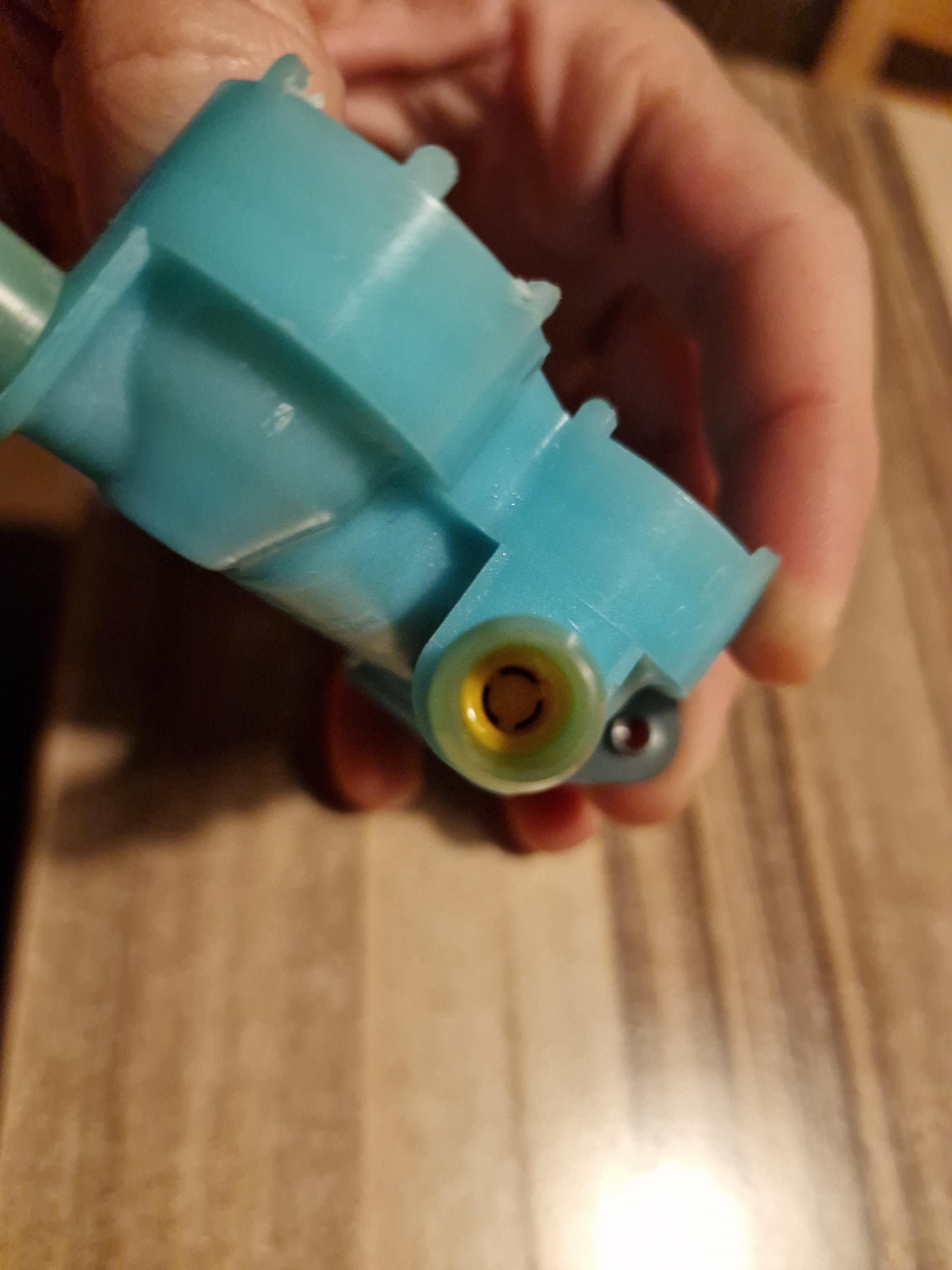

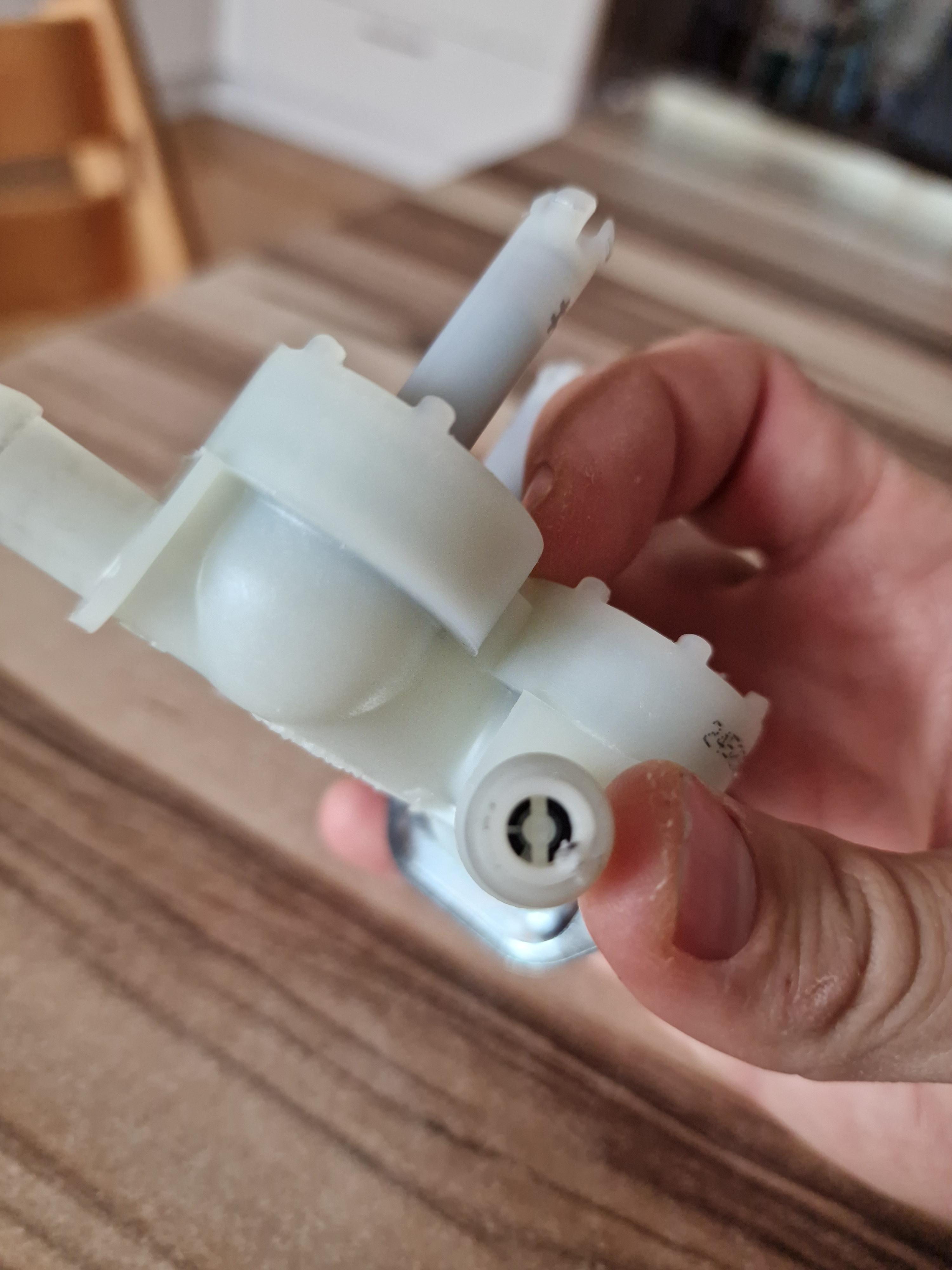

  7. Soo, update here: Turned out the chinese part had some kind of restrictor nozzle as well, but the flow was still way too strong! Also, the valves are glued in so no chance opening them. I ended up disassembling and cleaning the old valve finding, that one pusher was full of lime. I cleaned it with vinegar and cleaned all the rubber parts as well, put everything back together and insalled the old valve. Now, the machine works perfectly again! What can be learned: Don't buy the chinese crap parts of ebay/amazon. If so, try to swap the restrictor nozzle. DO NOT THROW AWAY THE OLD PART See ya!

  8. Hey guys, I had the same exact issue! Swapped the Inlet Valve due to overnight fillup and started having troubles with the dryer function. Clothes got out extremely wet and I could hear water flowing in beginning after ~5minutes in and never stopped. I also threw away my old inlet valve but I managed to get it back out the trash before it was gone forever 🤣 There is definitely a restrictor in the valve-outlet to the dryer! The cheap amazon part does not have that. I assume this is the issue. I will update tomorrow after testing the drying function :)

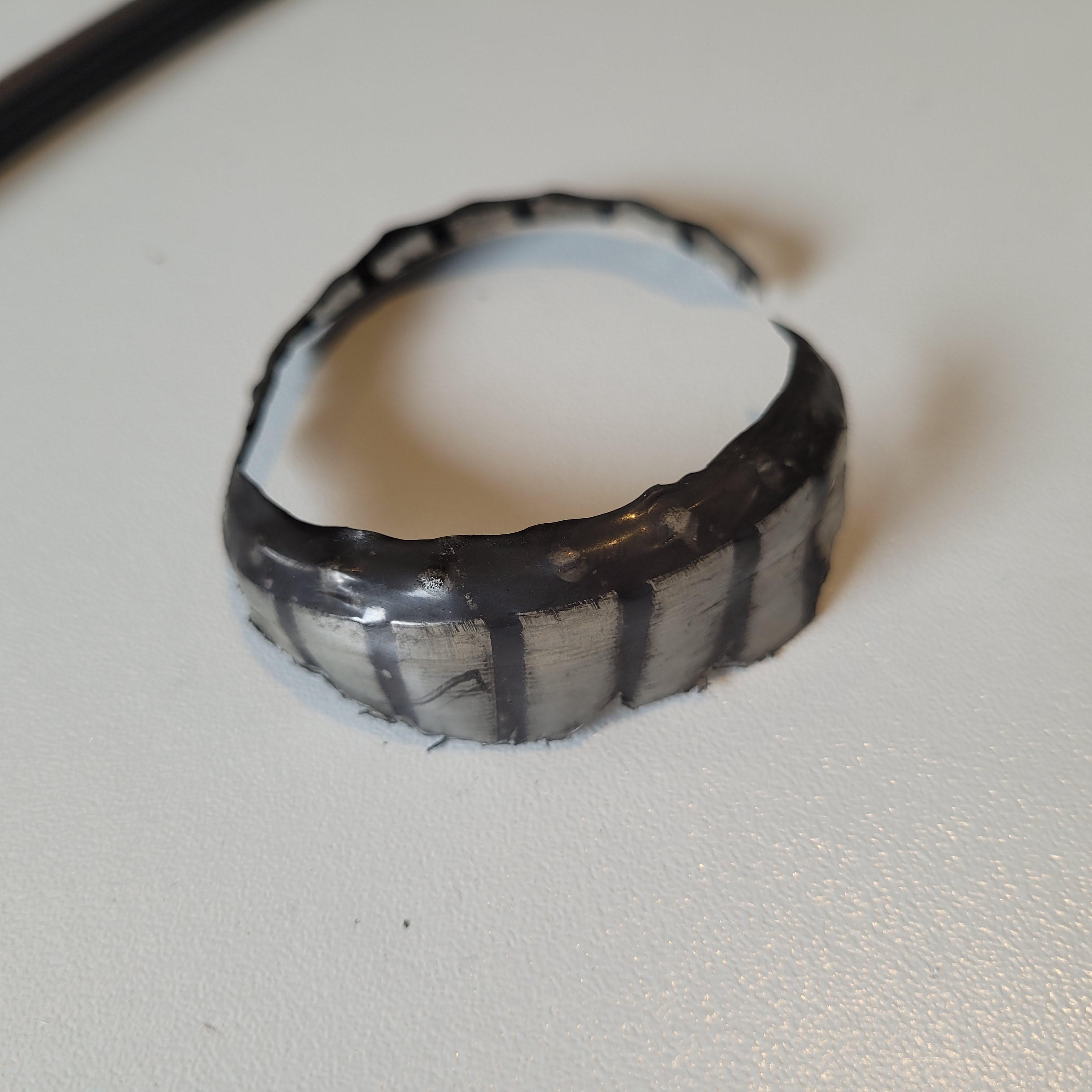

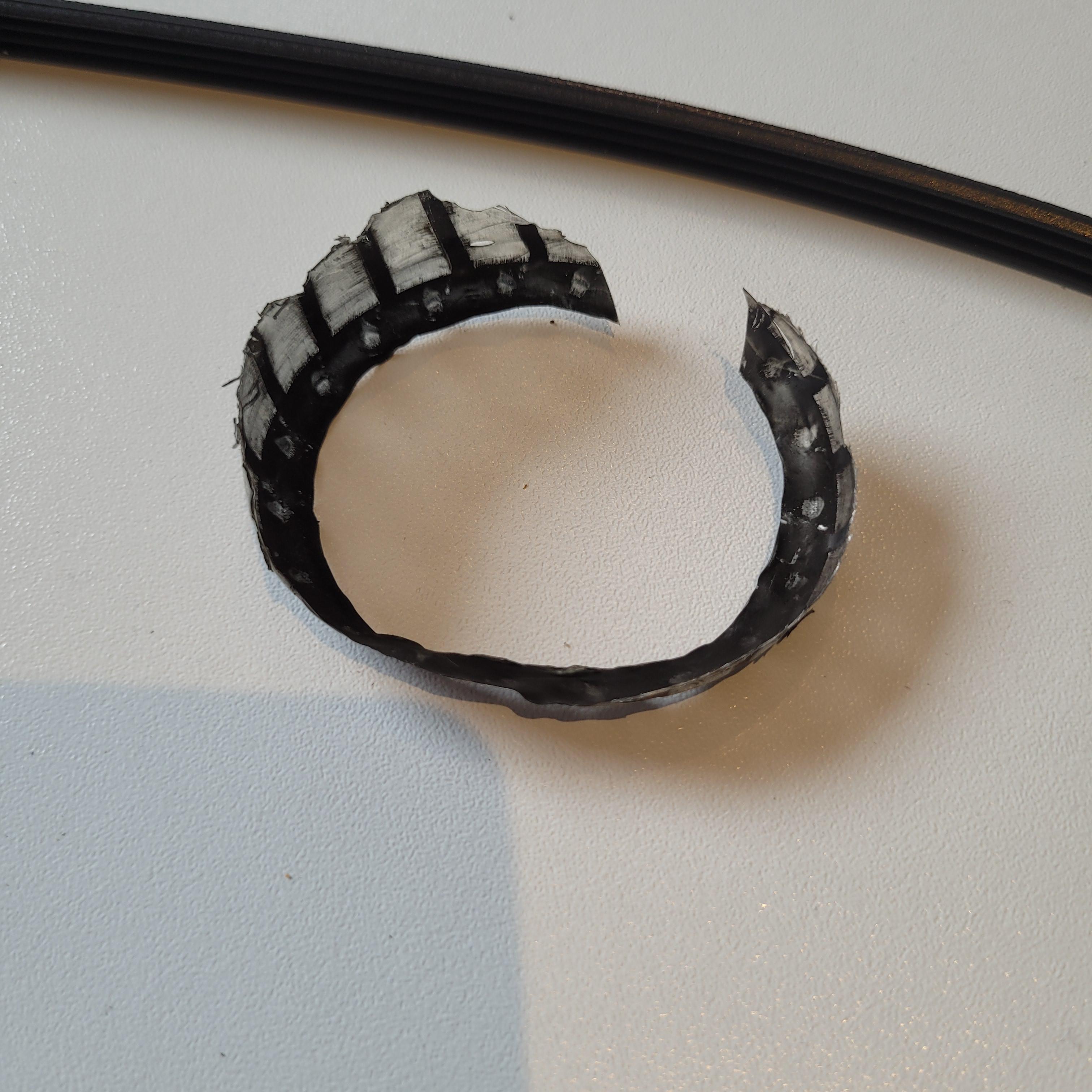

  16. OK so this is a weird one. I've watched lots of videos explaining how to replace brushes on a Beko machine and none of them featured thick plastic being pulled out the motor or being stuck to brushes. So I'm thinking it's protective plastic covering the commutator that should have been removed during manufacturing? It was causing a grinding noise. It was not originally tripping the power. It's only doing that since removing the plastic. Pics included. Anyway, although there's no more bits being released onto the floor under the machine and I've removed most if not all the plastic and the machine doesnt make any grinding noises anymore the machine still trips the power when its in spin cycle. Any ideas?! Model number is BEKO WTG620M1W TiA! Solution: Plastic sheath around commutator should have been removed when manufactured. Removed motor and opened the two steel chassis sections to reveal severely damaged commutator with deep gouges, see photo. Replacement motor bought Part required: Arcelik 2842510100 motor
