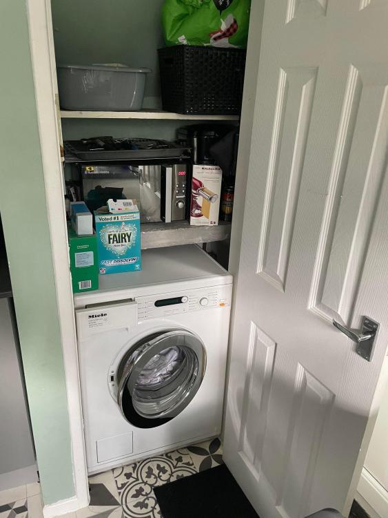

Miele W5740 time stops and cycle carries on and unusual noise on spin
andyr12345 and one other reacted to Asparagus for a topic
Anyway, we've checked the drain hose and there aren't any blockages there. We've put the washing machine in its place. A bit tight but the washer isn't touching anything. The only thing that worries me is that there's a ventilation vent and sometimes can get a bit cold. Not freezing cold though. Is it alright for the washing machine to live in a cold area or should we block this vent? I know that some people keep washing machines in garages. I think I must've selected rinse hold then cause I've done several loads since then without any problems. Stupid me for creating a problem where there wasn't any problem.2 points -
Not a question, this is a result that I found that might help someone. I have the above washer dryer that wouldn't fill when a programme was started, the drum turned as if in a cycle. This would happen with any programme that I turned it onto. I was at my wits end and nearly was thinking of buying a new machine. I then remembered somewhere about resetting the machine memory by pressing the 'Start/Pause' button continuously. I watched the LED light cycle through green then amber then back to green again. When I started a programme again the water filled as normal. I don't know if this works for other makes of machine. So again: 1. With the washing machine on, press and hold the 'start/pause' button and watch the LED light cycle through green then amber then back to green again. 2. Start your programme as normal. I hope this can be of use to someone, I'm not sure if this is the right place in this forum to put this, or if this has been posted on this forum before, apologies if this is so.2 points
