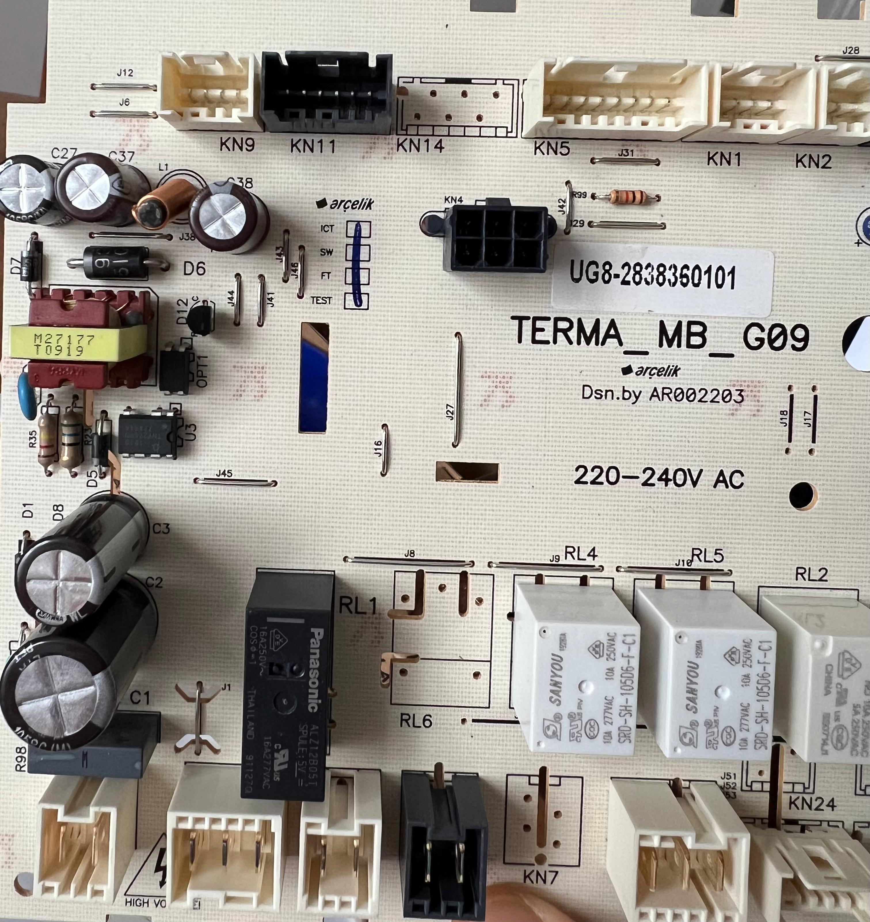

Hello all, my washer dryer BEKO WDIY854310F 2018 model doesn't turn on. I've seen great advice on this forum about the failing diodes, so I've removed the PCB and tested the diodes. I was expecting the D7 to be faulty, but it reads .315v and OL in the opposite direction. That made me think the D7 is ok. I've tested all diodes and find out D6 is faulty (.000 readings in both directions). Could you please help me choose the right replacement for the D6? What should I look for? Thank you

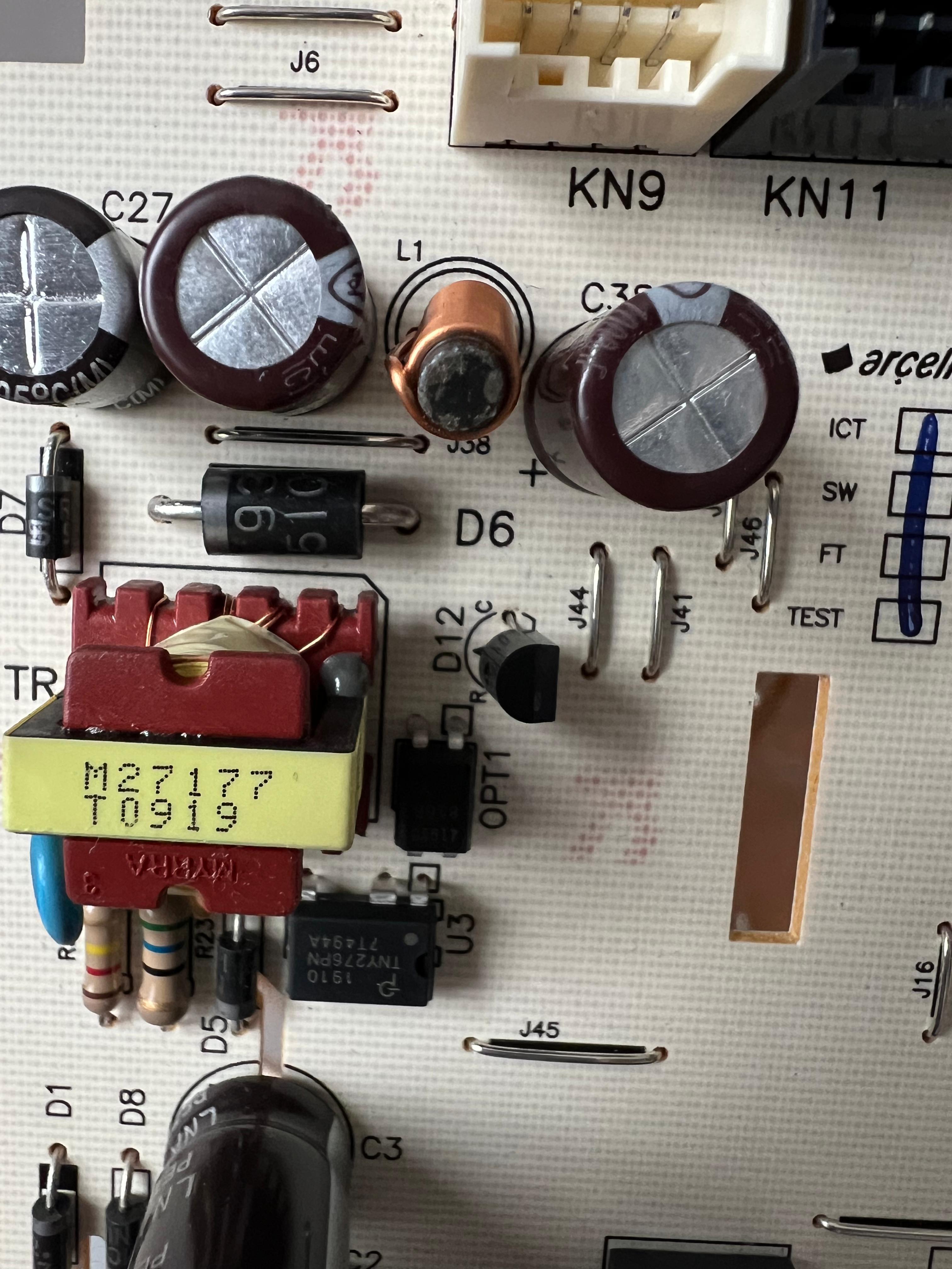

The number I can see on the D6 is 93 510
I don't have any experience in this field, so this would be my first diode replacement. Hope to sort it out in the end. Many thanks

Thanks, In my case the D6 was faulty. I've found a kind seller on ebay who advised which diode can replace the D6 (the SR5100). Got one replacement, soldered it into place and now the washing machine is working again.
