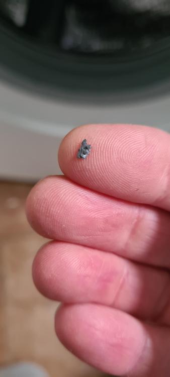

Thank you for replying. Inside of the drum looks fine, but there are lots of small grey hard bits in there (picture). The drum does knock when you turn it from the front, but it also makes a scraping noise at certain parts of the rotation. Trying to attach a video but need to make it smaller.
To me, it sounds like the drum spider at the back of the drum has corroded away and has got a crack in it. This usually happens on older washing machines, or washing machines where not enough detergent has been used, or mostly only low temperature washes, over a long period. It's probably best to replace the machine.
