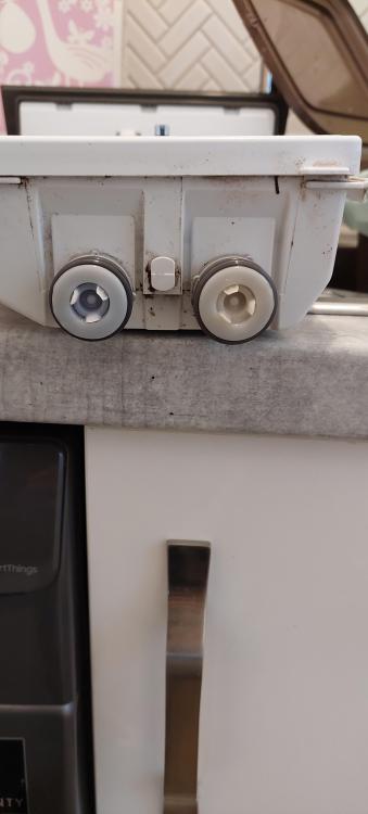

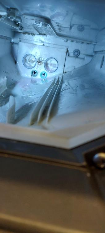

Any advice? I have tried cleaning the mating  ports at the back of the washing machine with a cotton bud ( incase any thing was clogged) but this done nothing.
I've attached two pictures. One showing the valve which is dispensing softner when pressed and the matting bit which I have tried to clean.

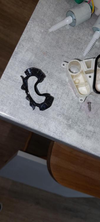

If it is not a blockage, it could be failure of the auto dose pump gasket.
I was reading about auto dose a few weeks back, and there's a thread on Samsung's community website showing a deformed pump gasket.  Possibly they've made a poor choice of material for the seal, fabric conditioner could cause some types of rubber to swells up.

After having a look, it was a deformed pump gasket. I've managed to find a new pump on ebay as it seems impossible to get a replacement gasket

I wonder when the gaskets have deformed like this on the autodose pumps that you can get some of this instant gasket in a tube (from motor factors or someone like Halfords) and make a new gasket and it work?, i cannot see why not
Possibly, but if the pump is made from a "waxy" low surface energy type of plastic, then you might need to pre-treat the surface with a LSE plastic primer if you need the sealant to stick properly and give it the best chance of staying in place,   The plastic casting may be marked with letters to indicate the type, if not water will bead up on LSE plastics.
Cutting a gasket from a chemical resistant rubber might be worth a try, but that's only easy if you can get away with a bit of overhang each side of the join without fouling anything.
Another option might be an O-ring.

Totally agree, the OP could check theirs for a label with the part no on to see if it is the same pump as in samsung's other machines, part no is DC97-19821A, which seems to be readily available,
https://www.samsungspares.co.uk/laundry/washing-machine/dispenser-pump/product.pl?pid=5345648&path=627424,627463&refine=dispenser
Seem to be quite a lot of negative reviews about the seal failing too, so you'd think they'd make replacement gaskets available, instead of replacing a £100+ part.
I believe those pumps draw the detergent and conditioner out of reservoirs in the draw and squirt it back into draw compartment, and with a leaking seal the pump wont suck. I thought at first the seal had swollen a bit, but from a closer look I think it might have gone so soft it has totally misshapen, arguably a design fault, so there ought to be a free fix.
I wouldn’t be surprised if the liquid detergent itself is the cause of these seals becoming soft and warping. That would be a design fault.

Hello there. Does anybody found out a way to fix this ? Recently I used epoxy instead of the rubber seals, worked great at the begining but failed again. I saw that if you heat up the epoxy it turns from hard into almost liquid ! My next try wil be with poxipol. Does anybody know if there is a new model/reengineered of the auto dose sistem? Thank you.
