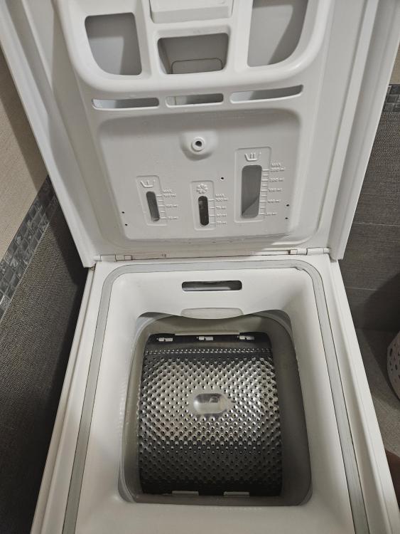

The drum of the laundry machine seems to be stuck on its "back" instead of the position in which i could take the laundry out(wgere the flaps are). I tried rotating it manually but it doesnt work.
Does anyone have any idea how i could fix this? Any help would be very very much appreciated.

The issue was indeed that the latch came undone so that the laundry spilled out and jammed the drum.
After forcing a sock and some swim trunks out the drain hole/pipe we took the side pannel off, and after laying it on the side to have gravity help us we managed to shimmy the drum into the correct position and recovering the rest of the laundry.
While he was rotating the wheel where the motor/drum strap is i manually tried pushing the drum from the top. Thankfully it worked so the issue was resolved with minimum casualties(the sock and swim trunks got ripped).
