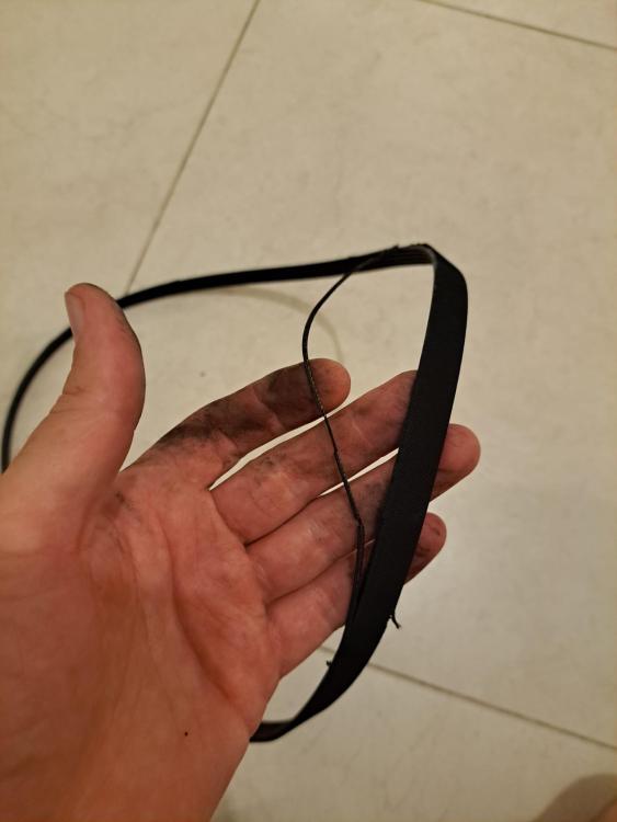

Morray Posted August 24, 2023 Author Posted August 24, 2023 I have removed the belt, and the drum is moving freely. This is the belt condition. Should I relace it?
Root Admin Whitegoodshelp Posted August 24, 2023 Root Admin Posted August 24, 2023 Definitely. It could be the source of the rubber noise. Morray 1 Need a repair or spare parts? Book a Repair | Spares4Appliances WARNING: Read this before attempting any diy repairs. No representations or warranties are made (express or implied) as to the reliability, accuracy or completeness of advice. I can't be held liable for any loss arising directly or indirectly from the use of, or any action taken in reliance on, any information on this website, which is given free of charge and in good faith.

Morray Posted August 24, 2023 Author Posted August 24, 2023 Yes, the drum moves nice and quietly. I will buy tomorrow a new belt and update. Thanks for the help so far. Whitegoodshelp 1
Morray Posted August 25, 2023 Author Posted August 25, 2023 Works like magic with the new belt. 20230825_183701.mp4 Thank you very much Whitegoodshelp 1
