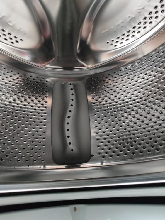

I'm having trouble finding the release clasp of the drum paddle of an indesit iwdc6125. Any ideas of which hole it's under or if it's a different method for this type?

The chances are that it pushes backwards in order to come off. That's the direction there is space for it to move into. So it should just be a question of gently pressing a small thin screwdriver down each hole to see if there is any give there that could be something that pushes down to release the lifter.
However, there's always the possibility that it could move left or right in order to come off. But if so they would have to be some sort of release mechanism because the lifter would be subject to left and right pressure as it revolves the laundry around.
If there is no give in any of the holes that is different to the other ones then there can't be any release mechanism under there. In that case maybe it needs a firm knock to release it, but obviously not knowing which way to do it is a problem because you do not want to break it.

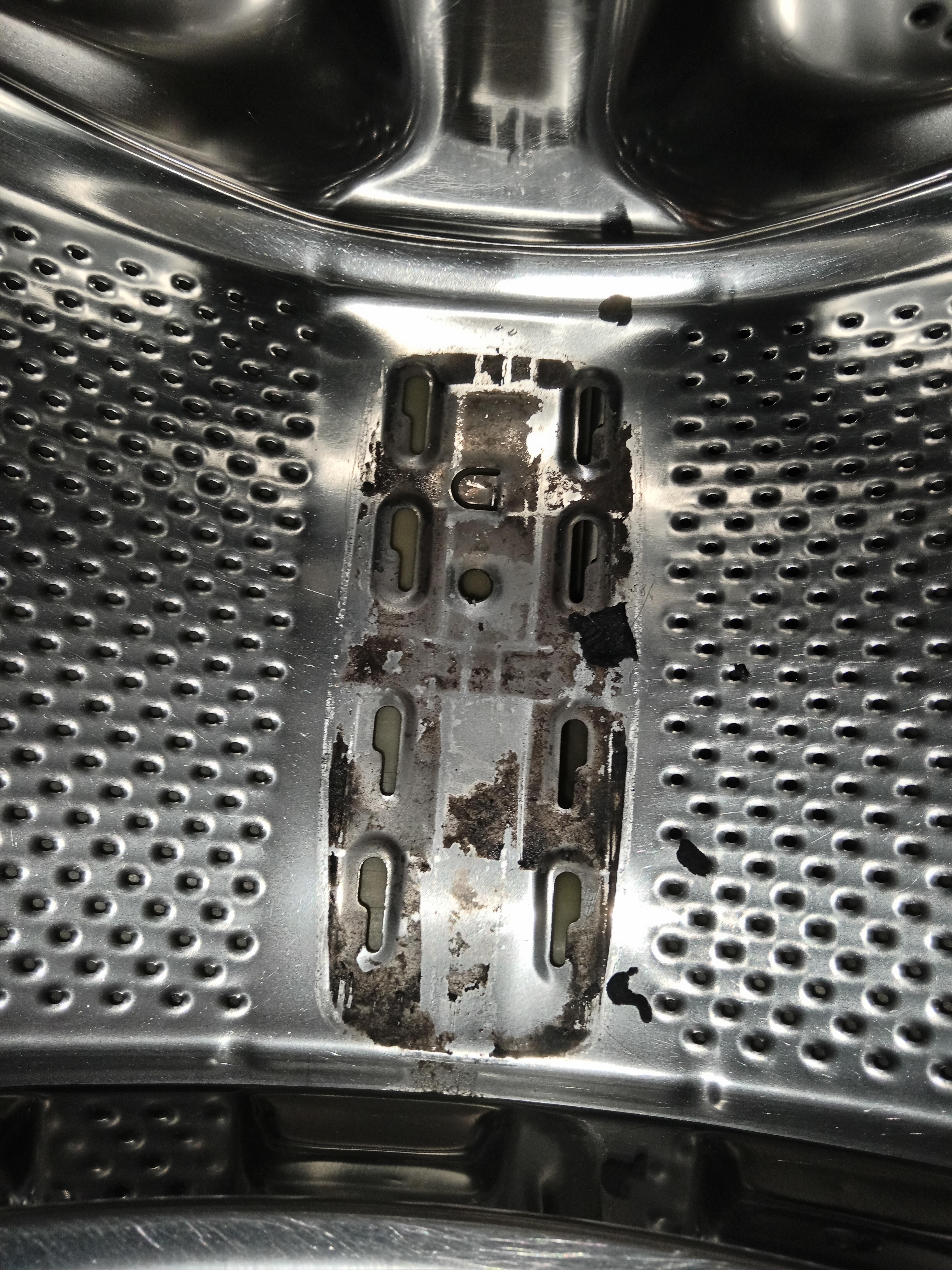

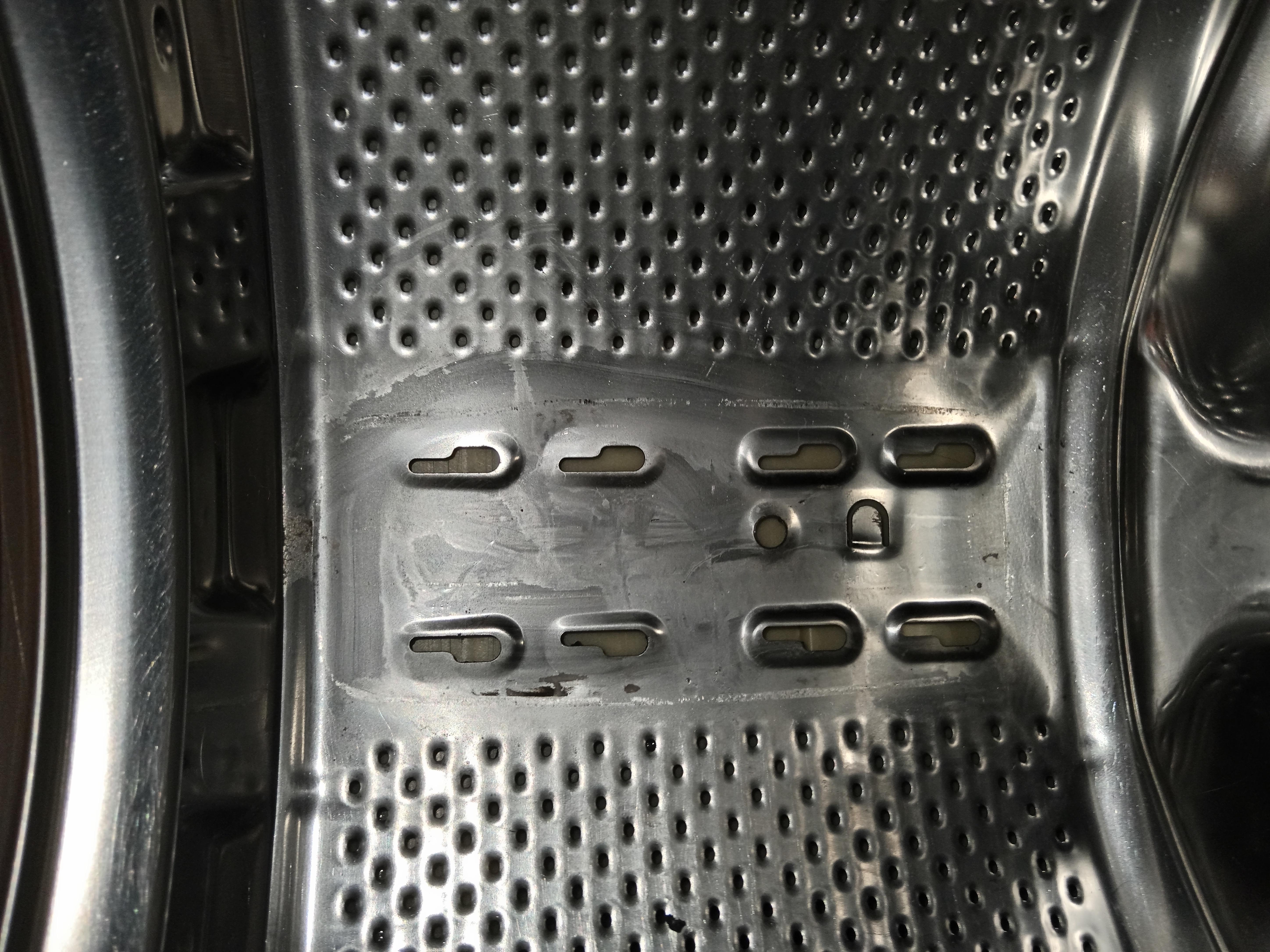

Since I scoured the Internet for like 3 hours also trying to figure this out, only to use my wife's otoscope to find the frigging tab, I thought I'd share for future searchers. On my washing machine, Indesit IWDC6125 Washer dryer combo, the tab is through the second hole from the back of the drum. You have to push it down and towards the left.
Many thanks for that Jude, very useful.
