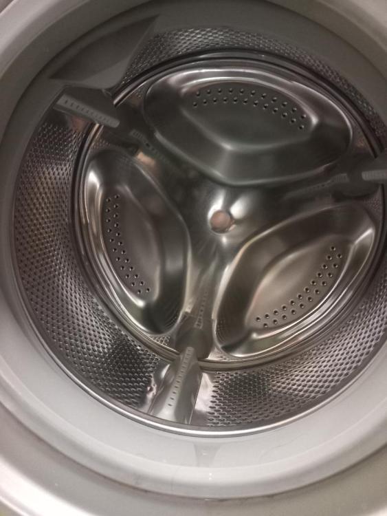

Hotpoint Washing Machine WMFUG742G spins however it rubs at two particular points. Does this both while running on cycle or when turned by hand. Machine seems level however have leaned it back and forward to no change in case it was due to the washing machine being at an odd angle.
When rotating the drum by hand can see gap appearing at the top as the uneven side gets to it as if drum is no longer circular. If I push the drum up and to the right, the drum evens out and goes round without rubbing.
No other noises.
Pictures show gap at top and the drum rolled round for same spot at the bottom to show difference. Drum rubs bottom right as it turns up, enough to make a noise, and slight rubs the tab top left but only enough to feel it hinder movement but not make noise when rotating by hand.

Gone round the drum and it feels solid. It's only when I'm lifting the section which seems to have deformed to leave a gap at the top, there I'm able to push it up (feels more like I'm bending it up).
