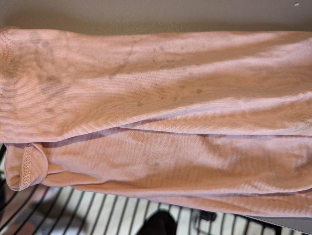

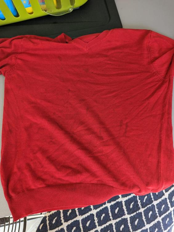

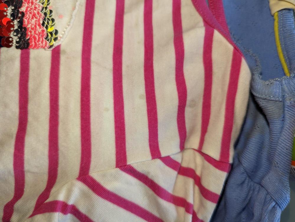

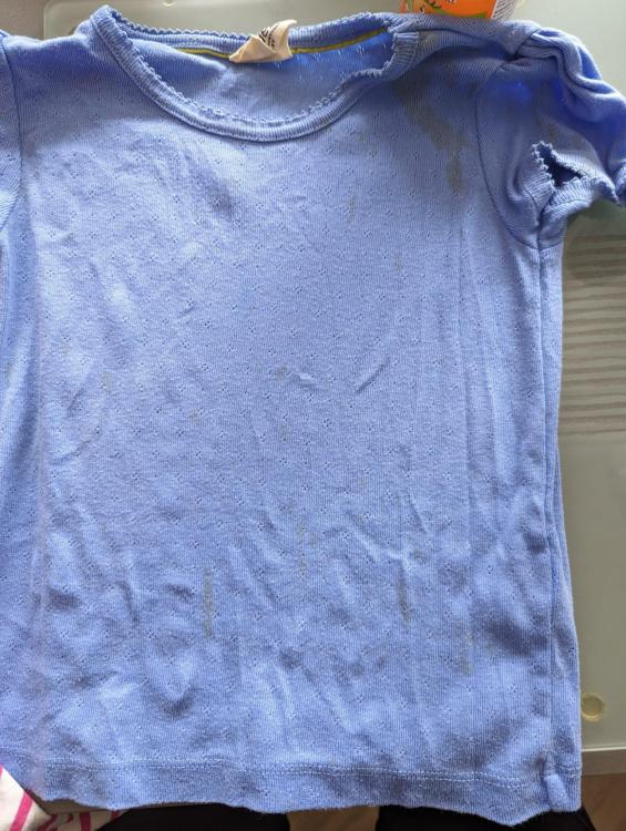

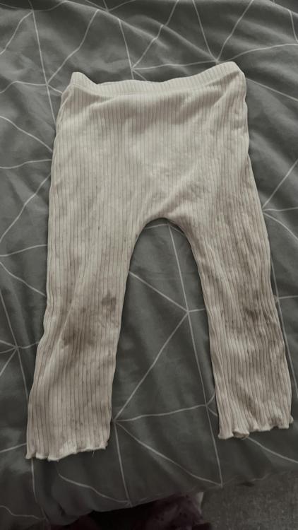

I was hoping someone could help us. We’re having an absolute nightmare with our washing machine. Some of our clothes are coming out with dark spots and larger stained areas (brown, sometimes look almost black and sometimes a bit orange – obviously some of this depends on the colour of clothing) on that are impossible to wash out. My first instincts, like yours most likely will be, are that it’s something we’re doing but I have ruled pretty much everything out.
It all started with our previous Samsung machine and we actually had Samsung in to look at the machine and they couldn’t see much but replaced the drum. We found it still carried on doing it and unfortunately, our machine had fallen out of warranty so we decided to replace the machine.
We now have a Bosch Series 4 machine (WAN28250GB) and we still have the same problem.
We’ve tried everything:
·         Where the machine drains
·         Different powder, liquids and capsules
·         Different temperatures (does it across all temperatures)
·         Sort the washing by whites, lights, colours and darks and we’ve noticed it across all
·         Use colour catcher sheets
·         Don’t use softener
·         Also washed clothes in other people’s machines and all come out clear of marks.
We find that it mostly does it on cottons and in this fabric, it’s pretty much impossible to get out. Tried Vanish Oxi spray and powder, white vinegar, lemon juice, standard Vanish, you name it!

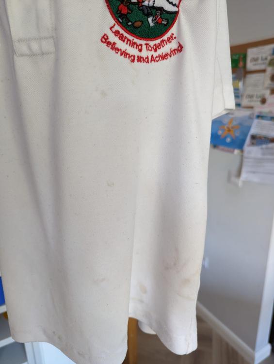

It doesn’t do it on every wash, and it doesn’t appear on every item in the wash. It sometimes does something random, like on a recent wash, the only item it did it on was my son’s white school polo which is 50% cotton and 50% polyester. This was strange as they have never been affected before.
I wondered if it was rust from the pipes or water but I’ve tried soaking according to what Vanish say and have tried specific rust remover, white vinegar and lemon juice and this doesn’t work. The pipes are also relatively new, so I can’t see it being this. We’ve never noticed it coming out of the water either.
Is it possible that it’s some sort of reaction? I really can’t see it being the machine as it also did it with our Samsung machine.
We’re at a total loss now as to what it could be, and what we could do to try and solve this problem. We’re constantly ruining clothes and any help is much appreciated!
See some of the clothes that this has affected in the attached images.
