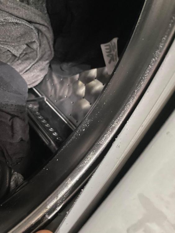

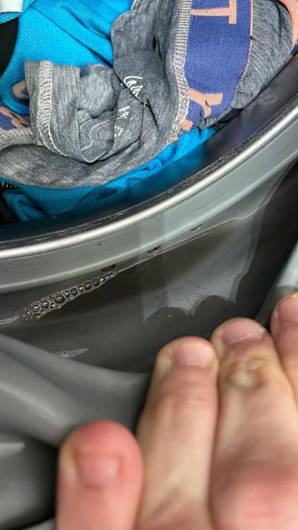

So I moved the water pipe about and luckily it did get more water but as it was about to spin, started making a noise I've not heard before as in the video.

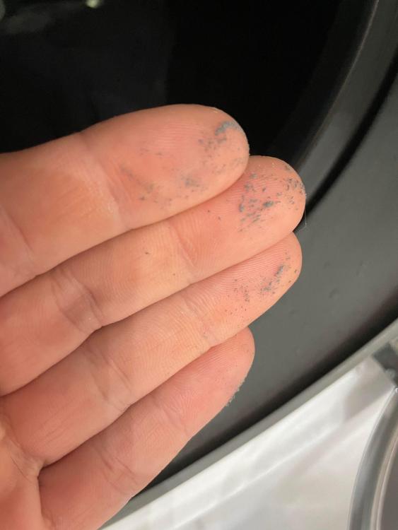

Then when it finished there's some kind of powder like residue inside. It's grey.
What happened to it?

That last video sounds like the drum is catching on the door seal. I would check the drum pulley isn't loose at the back.
Looks like corrosion has damaged something. I dismantled a bit and the bottom of the washer is in a shocking state.
No point in wasting  money and time on it. We were hoping to save money buying second hand, but as it sometimes turns out, you end up paying more.
