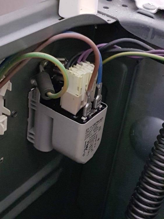

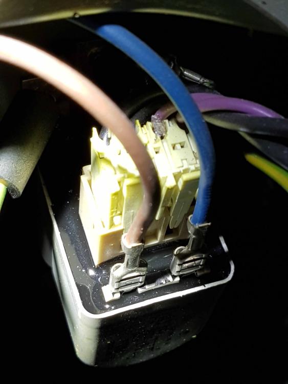

harrygee Posted February 27, 2023 Author Posted February 27, 2023 Hi Andy I have possible good news! I took the top off the machine and found the mains suppressor at the back ; it had a pool of liquid gum sitting on the top with some liquid below it on the base of the machine. I attach photos. I guess it should not be in this state and looks like the culprit? I have searched and found replacements are not too difficult to source so I may just buy and swap out which hopefully may solve the problem. Do you think this looks like the source of the bang and smell? Re.Miele I rang this morning to be told the earliest date to visit is 9th March ; ridiculous! So I declined.I quite agree the pricing structure is crazy and I do hope I have found the problem myself Cheers Whitegoodshelp 1
Root Admin Whitegoodshelp Posted February 27, 2023 Root Admin Posted February 27, 2023 That's the part that can go with a bang when not even running. The live and neutral run throughout and if the insulation between them breaks down inside they can short out. You should be able to smell if it's the part that blew though don't touch the contacts with your nose as they can hold a charge. Can't rule out the possibility that something else for damaged when it blew but hopefully not. Need a repair or spare parts? Book a Repair | Spares4Appliances WARNING: Read this before attempting any diy repairs. No representations or warranties are made (express or implied) as to the reliability, accuracy or completeness of advice. I can't be held liable for any loss arising directly or indirectly from the use of, or any action taken in reliance on, any information on this website, which is given free of charge and in good faith.
