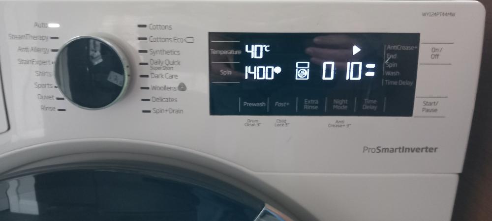

I'm thinking it's needing a reset but there's no info on doing it as it doesn't have the buttons that you're told to press. (See pic).

Thanks for the update. That seems like it's made a big difference. There's no reset on most washing machines. If there's a fault, it triggers an error code. When the fault is fixed, the error code disappears.
