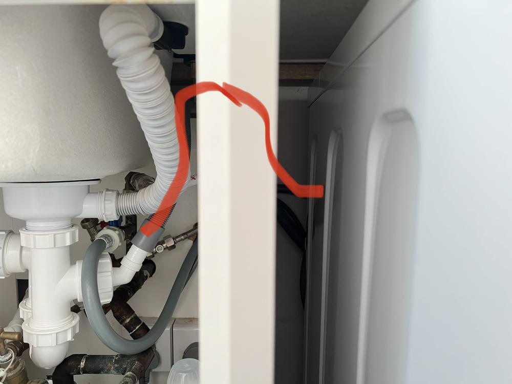

chesterflaps Posted January 17, 2023 Posted January 17, 2023 Hi. For the past few months, my clothes continue to have a foisty smell after washing. Before this happened, I'd hang my washing on the landing and my whole house would smell of clean washing. Now it smells of sewage (maybe exaggerating). The washing machine is only about 3 months old. Things I've tried Washing at higher temp, moved the waste from underneath the sink trap and located above the trap, put the waste pipe in the right position up and over and facing down (as per pic), used washing machine cleaner, tried biological powder instead of non bio, cleaned the filter and hose at the front near the bottom. I really am out of ideas and need some help. I have a really strong sense of smell and feel really self conscious about horrible smelling clothes.
Root Admin Whitegoodshelp Posted January 17, 2023 Root Admin Posted January 17, 2023 Hello there. I'm presuming that it is the grey hose that is the washing machine hose. Before I advise any further, can you just confirm that the waste pipe under the sink has a proper U bend? I can't make it out properly from the photo, if it does have a U bend it looks quite shallow? Would the whole pipe in the U bend remain full of water at all times? Need a repair or spare parts? Book a Repair | Spares4Appliances WARNING: Read this before attempting any diy repairs. No representations or warranties are made (express or implied) as to the reliability, accuracy or completeness of advice. I can't be held liable for any loss arising directly or indirectly from the use of, or any action taken in reliance on, any information on this website, which is given free of charge and in good faith.
chesterflaps Posted January 17, 2023 Author Posted January 17, 2023 (edited) This is the waste. It does have a U bend. I've tried to draw it how it is. Edited January 17, 2023 by chesterflaps Typo

Root Admin Whitegoodshelp Posted January 17, 2023 Root Admin Posted January 17, 2023 Hi. It may not be anything to do with the u-bend, but it's worth ruling it out first. Is it like this one? Ideally it should be fairly deep like this - The u-bend should be completely full of water when all water has stopped running through it. No air should be able to get past this water, that's what prevents smells from the drain coming back up. I'm just wondering if it's not a proper u-bend then air could get past the water. Need a repair or spare parts? Book a Repair | Spares4Appliances WARNING: Read this before attempting any diy repairs. No representations or warranties are made (express or implied) as to the reliability, accuracy or completeness of advice. I can't be held liable for any loss arising directly or indirectly from the use of, or any action taken in reliance on, any information on this website, which is given free of charge and in good faith.

chesterflaps Posted January 17, 2023 Author Posted January 17, 2023 9 minutes ago, Whitegoodshelp (Andy) said: Hi. It may not be anything to do with the u-bend, but it's worth ruling it out first. Is it like this one? Ideally it should be fairly deep like this - The u-bend should be completely full of water when all water has stopped running through it. No air should be able to get past this water, that's what prevents smells from the drain coming back up. I'm just wondering if it's not a proper u-bend then air could get past the water. It doesn't look particularly shallow. What do you think?

andyr12345 Posted January 17, 2023 Posted January 17, 2023 55 minutes ago, chesterflaps said: Hi. For the past few months, my clothes continue to have a foisty smell after washing. Before this happened, I'd hang my washing on the landing and my whole house would smell of clean washing. Now it smells of sewage (maybe exaggerating). The washing machine is only about 3 months old. Things I've tried put the waste pipe in the right position up and over and facing down (as per pic), So for a certain time have you had the waste pipe from the washing machine machine pointing up then? - this definately would have mean that everything that has gone down your sink has ended up going down the grey flexible pipe heading towards your washing ... which would not have been good!
chesterflaps Posted January 17, 2023 Author Posted January 17, 2023 3 minutes ago, andyr12345 said: So for a certain time have you had the waste pipe from the washing machine machine pointing up then? - this definately would have mean that everything that has gone down your sink has ended up going down the grey flexible pipe heading towards your washing ... which would not have been good! No, I just wanted to confirm it's pointing down as well as it being positioned correctly. andyr12345 1
Root Admin Whitegoodshelp Posted January 17, 2023 Root Admin Posted January 17, 2023 26 minutes ago, chesterflaps said: It doesn't look particularly shallow. What do you think? That's a much better photo thanks, aye it looks deep enough. The drain hose is attached properly too and going up and over before running down to the washing machine. Can you smell the smell inside the washing machine, or in the cupboard? Need a repair or spare parts? Book a Repair | Spares4Appliances WARNING: Read this before attempting any diy repairs. No representations or warranties are made (express or implied) as to the reliability, accuracy or completeness of advice. I can't be held liable for any loss arising directly or indirectly from the use of, or any action taken in reliance on, any information on this website, which is given free of charge and in good faith.
