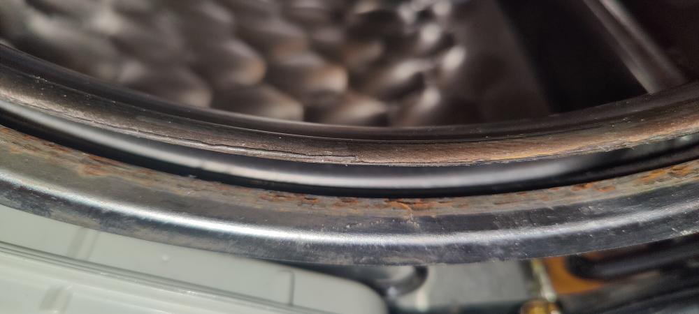

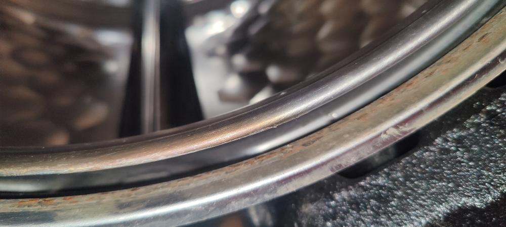

dolevo Posted January 8, 2023 Author Posted January 8, 2023 @Whitegoodshelp (Andy), hi again. I have dismantled the machine and wanted to share my findings. Please see my video here: https://youtu.be/Cfgh5PWuXEU Please notice the color chance on the metal due to friction. The color chance is only at the side where the corner of the drum became sharp.
